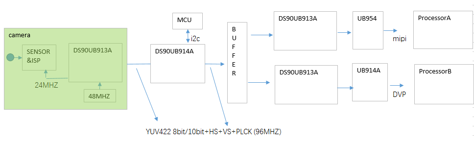

Hello,team
Is there any application note about DS90UB913A work with DS90UB954?
we want to use DS90UB913A with DS90UB954 to transmit YUV422 8bit/10bit+HS+VS+PLCK (96MHZ) data
could you give me some advice about application as below

1. From the application block diagram, UB913a/ub914a/ub954 can be used here. it would be better if you select UB934 to replace UB914a in your case. One key point is that please note the buffer's channel to channel skew spec, please follow up TI's UB913a's input timing (setup / hold timing of PCLK vs Data/HS/VS)
2. Regarding the app. note between ub913a and UB954, this is one typical application for UB954, please: a. select the correct MODE; b. if PoC is used, please make sure both ub913a and UB954 works with the similar PoC network as UB913a EVM board.

hello
thank you for your quick reply
how to use similar POC network as UB913a EVM board?
I donot know the meaning of POC network
best regards
juan
Juan,
can you refer to page21 in my.ti.com (http://www.ti.com/lit/ug/snlu135b/snlu135b.pdf
Juan,
can you refer to page21 in my.ti.com (http://www.ti.com/lit/ug/snlu135b/snlu135b.pdf on PoC design (L2/L4/L16, etc.)?
