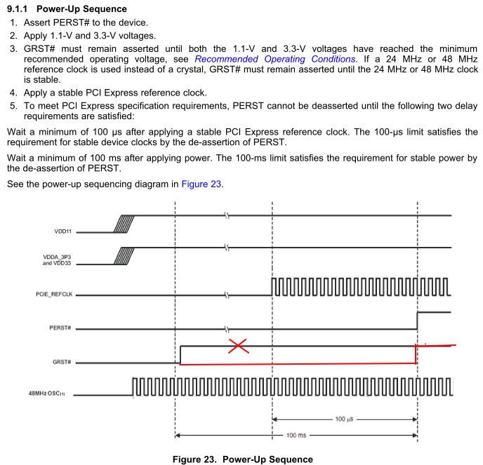

Dear Team,
Is it acceptable to have the below sequence?
BR
Keivn
Dear Malik
Since we do not find the description of the relation between GRSTn and PERSTn in the datasheet.
Could you provide the delay time from GRSTn to PERSTn and the description of why GRSTn should be deserted before PERSTn.
BR
Kevin
Hi Kevin,
There can be some system specific issues if PERST is not controlled separately. GRST and PERST can be connected together and de-asserted at the same time. However, if the customer wants to reset only the PCIe interface through PERST they will also reset TUSB7340 completely through GRST and will need to reconfigure TUSB7340 (as necessary). As for timing, >10us before PERST is de-asserted is sufficient for GRST.
