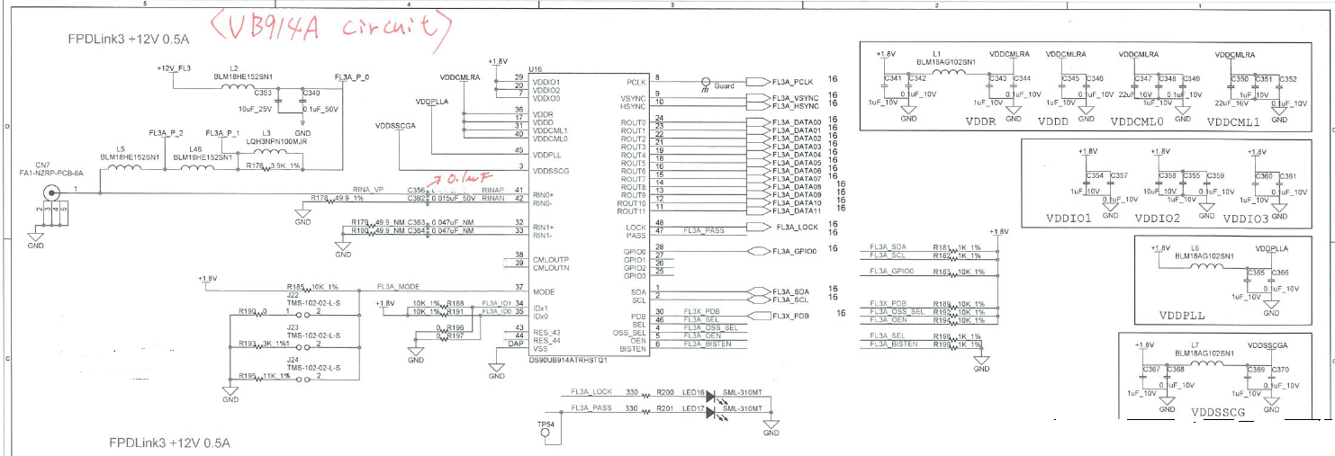

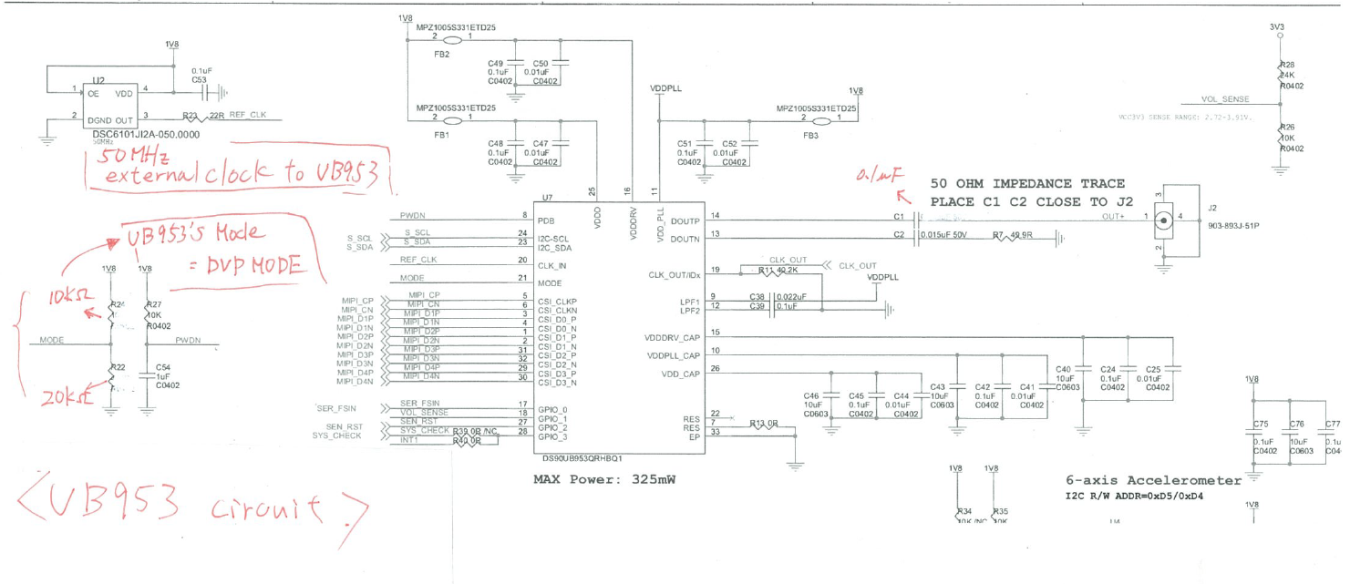

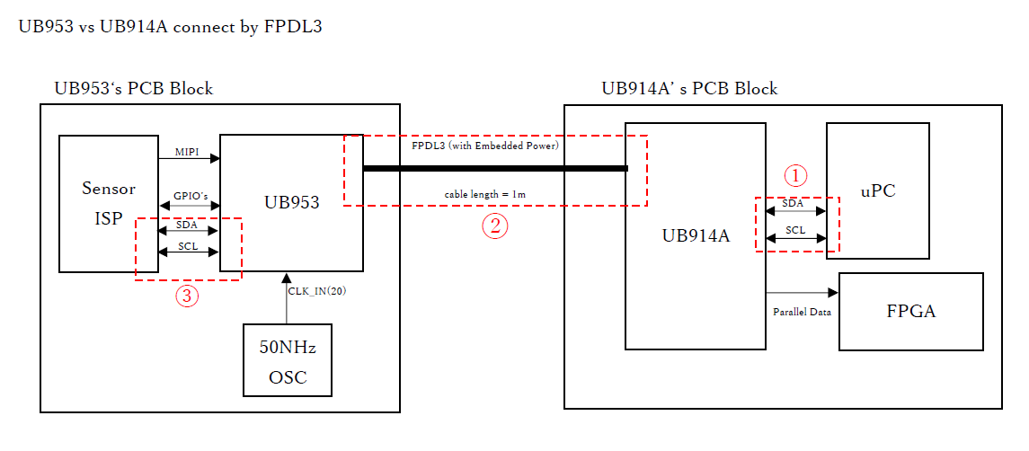

  • Hello, Steven. Thank you for your reply
    Our circuit block is the following.
     Our problem is I2C(No.2). can not access UB953's register via FPDL3 and UB914A from uPC.
     I2C(No.3) hasn't tried yet because I2C(No.2) doesn't work.
    UB953's circuit is the following.
    UB914a's circuit is the following.
    1.UB953' circuit does not have a microcomputer.
       UB953's mode and SlaveID are specified from the external pin.
        MODE : Marking voltage 1.2V, DVP mode.
        SLAVE ID : 0x18
    2. The uPC access whole of 914a's registers via I2C(No.1) .
        read data 0x30 from register 0x6.  (SER slave address, 0x18 <<1 shift = 0x30 )
        read data 0x03 from register 0x1C.(Link up & signal detected)
        write data 0x30 to register 0x7.(for access to 953's register)
    3. The uPC tried to access  953's register by I2C.
        But all of response were NAK...
    So in order to observe what is happening inside UB953, we connected the controller to the UB9537s I2C and checked the following registers.
    read data 0x00 from register 0x52.
    So UB953 status is not "back chennel link detect", "HS_PLL_LOCK" flag was bad condition and "RX_LOCK_DETECT" was different UB914A's status.
    Maybe I think  there is something missing from the initial settings for 953.
    I have some question.
    Q1. On UB953' register 0x52, What should be the value of A for proper operation?
    Q.2 Does the UB953 have contents to be set from the microcomputer?
    Q.3 Is it safe to connect UB14A to UB953?
    best regards

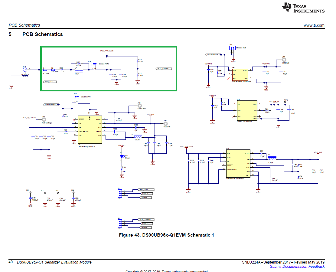

  • Hi, Steven
    We tried to check, I found a problem.
    I bought "DS90UB953-Q1EVM" and checked something.
    UB953's 0x52 register was following.(ALP window)
    ( It works the same with my 953's camera )
    It was good condition HS_PLL_LOCK, but LINK_DET and RX_LOCK_DETECT were bad condition.
    Maybe I think, our problem was POC circuit, we tried to FPDL3 Link operation on non POC.
    So we can access 953's register via FLDL3 cable and 914 from uPC.
    As a result, there were no problems with mode settings or register settings.
    Thanks to your sincere reply !

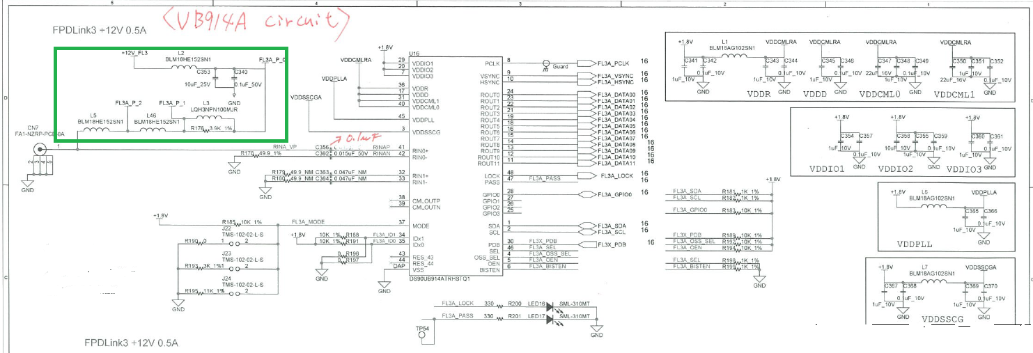

    And we have new question.
    Q.I think this issue is due to the influence of POC.
     We need POC(from 914's power source).
    @914's POC circuit( the areas marked in green)
    @934's POC circuit( the areas marked in green,"DS90UB953-Q1EVM" )
    Please I need some advice for specific parameters for POC between UB914 and UB953.
    best regards,
    Hiroshi Kamizono
  • Hi Kam,
    that is good.
    Yes, when ub953 is linked to UB914a or ub934, you should design UB953's POC circuit with UB914a's refer. circuit. The PoC network is dependent on the FC and BC data rate.
    In our app. note of how ub953 is linked to ub914a, it also has description how the hardware circuit is designed when you pair ub953 and ub914a. I believe you had follow up the app. note closely :(
    best regards,
    Steven
