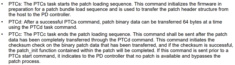

  • Hi Jeff,
    The setting may be set to where I2C1 and I2C2 are the same, I would recommend checking the TBT Controller I2C Port field in register 0x27 to see which I2C it's set to. You can also check to make sure you're using the latest GUI version 6.1.1.
    For the patching process, what is your BUSPOWERZ configuration set to? The host should wait until it receives the "READY_FOR_PATCH" notification from the PD device. Also, are you sending the soft reset "Gaid" command after "PTCr"? Once you have verified this and get the notification, you can start the patch loading process in the order shown below:
    There is also example code shown in section 3.1.3 of the document.
    Thank you,
