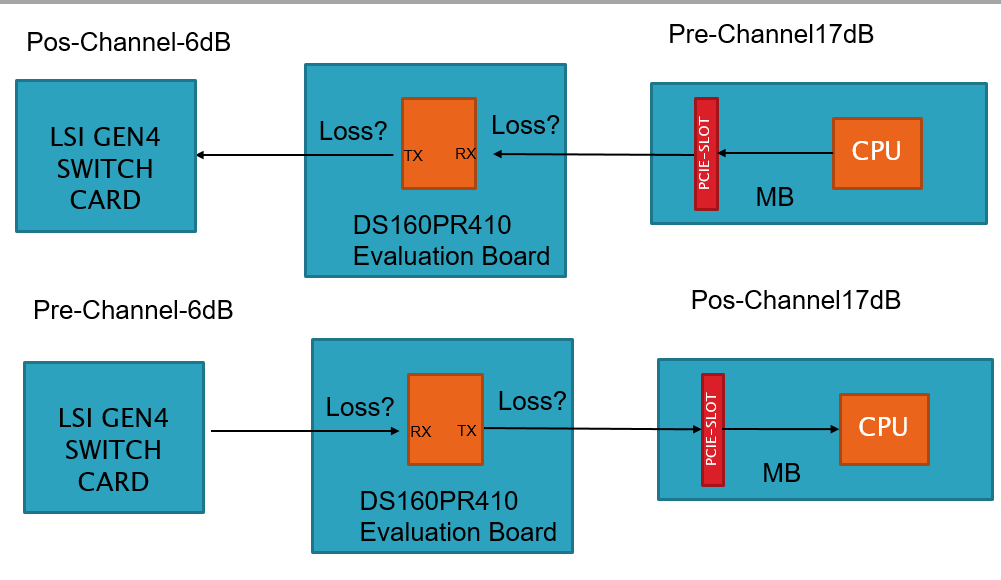

Could you have some suggestions for the EQ setting for the loss as below?
Also, may I know our EVM roughly loss for TX and RX?
Part Number: DS160PR410
Hi team,
The loss on both sides of the evaluation board is ~ 3 dB. This would make the total loss ~ 29dB.
I would suggest to set the DS160PR410 for a modest equalization setting. I recommend to use an equalization setting that is slightly lower than the minimum Pre-channel attenuation. In this case it is ~ 9 dB.
With 9dB attenuation in mind, I would recommend using EQ_index 3 or 4 from the datasheet to start out and see how the system reacts to the combination of PR410 and channel.
