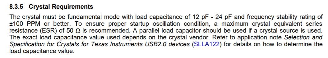

Hi team,
My customer would like to consult with you about the  load capacitance of crystal with TUSB8041.
The vendor of crystal has measured the crystal performance which the best result is operating with 33pF load capacitance.
But it has mentioned the load capacitance should be 12pF~24pF in our datasheet.
Could you kindly provide your advice could they use load capacitance at 33pF?
Is there any side effect with 33pF ?
