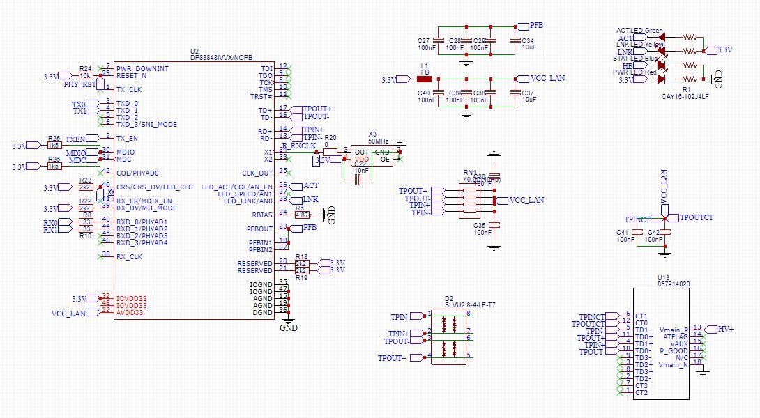

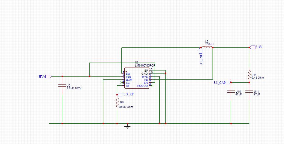

I have a board with DP83848I that we have made that appears to be getting hotter than expected. The board is powered off POE power with a LM5166YDRCR 3.3v regulator. this powers the MCU without any issues and appears to be very stable running a STM32F407VET without the MCU getting warm. The network connectivity works and functions as it should except the PHY is getting hot. When we run the board from a usb to Serial board with a 3.3v feed it appears to run a lot cooler over this than the POE. But it sill appears to be warmer than expected. I have a Dev board with the same MCU and PHY and the PHY does not get warm at all on Serial power. It would be appreciated if someone could provide some feedback on what maybe cause ing the PHY to get hot.
  • Hello Chris,
    Here are my comments on the schematic:
    • MDC does not require a pull-up
    • The center taps of the magnetics need to be grounded to GND and earth GND on either side of the magnetics
    • Please double check the power-feedback cap placement based on section "7.2.1.3 Power Feedback Circuit
    Are you able to isolate what component makes the board hot? Sorry it was a bit unclear to me whether it was the regulator, MCU or PHY that you suspect is causing the issue?
    Are you able to measure the power consumption of the isolated PHY?
    Vibhu
  • Hi Vibhu
    Thank you for your prompt response, just following up on the above points you made.
    • MDC does not require pullup - This has now been removed and has made no affect to the temp
    • Center taps of the magnetics to ground - Are you sure that this is correct to ground? the datasheet of the DP83848 says that this should be pulled to VDD and place capacitor close to the center taps. ( currently 0.700mm from TPOUTCT)
    •  Feedback cap placement - The Caps for these are placed 1.78mm from the PHY
    It has been hard to try and isolate what components make the board hot as it is on a printed circuit board. The rest of the board and components do not get hot at all including the regulator and MCU. It appears to only be the PHY that is getting hot and affected. I will attempt to see if I can measure the current of the PHY and let you know.
    Any further assistance would greatly be appreciated.
    Kind Regards
    Chris
  • Hello Chris,
    I apologize, you are correct about the center taps please follow "Figure 7-2. 10/100 Mb/s Twisted Pair Interface".
    Please let me know if you have been able to take the current measurement.
    Vibhu
  • Hi Vibhu,
    I'm Aaron and work with Chris.
    I have measured the current draw at the point noted below in green and found when running from an external 3.3V source it measures 95.8mA with minimal heat. When running on PoE (on-board regulator) it draws 98.9mA and heats up.
    Unfortunately I'm unable to measure the exact temperature without a temp gun.

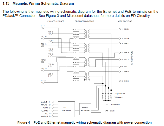

    Out of curiosity, is it necessary to have a power source that's electrically isolated from the PoE source? I'm not sure if the below schematic (from the mag-jack) sheds any light on the subject?

  • Hi Cecilia,
    Thanks for looking into this. Unfortunately due to the board design, it's not practical to measure from the 3.3V net. I could however measure the draw of the entire board if that's of interest? The next design will have a 0 Ohm resistor for each group of components for testing purposes. Did there appear to be any issues with the schematics?
    The PoE schematic comes from the RJ45 socket we're using with built in PoE. Please see product details here: https://www.molex.com/molex/products/datasheet.jsp?part=active/0857914020_MODULAR_JACKS_PLUG.xml

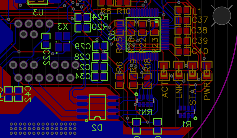

  • Do you have an image of your layout/routing you can share of the PHY? I'm wondering if the thermal pad was grounded properly to dissipate all the heat on the chip.
    Cecilia
  • Hi Cecilia,
    The DP83848I doesn't have a grounding / heat sink pad, but happy to show you the layout. I'm currently out of the office but will forward it as soon at possible.
    Kind regards,
  • Hi Aaron,
    Not a problem. Please provide the layout at your most convenient time.
    Cecilia
  • Hi Cecilia,
    Please see below for partial board layout. As this is a public forum, I'd prefer not to show the whole design. Happy to forward a copy in private if you can advise of where to send it.
  • Hi Aaron,
    For your LEDs on your schematic:
    • Were you intending on strapping the pins or are the straps on a different page of your schematic?
    • What are the resistor values and current limit on the LEDs?
    • Could you perhaps remove the resistors and see if the LEDs are sinking current causing the thermal issue?
