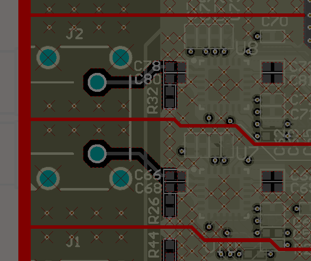

Also, I was thinking that our PCB design may be imperfect (it came from old 3G-SDI design):
(latter is nearest GND layer, all other layers has similar cutouts)
Can such pcb design cause this issue?

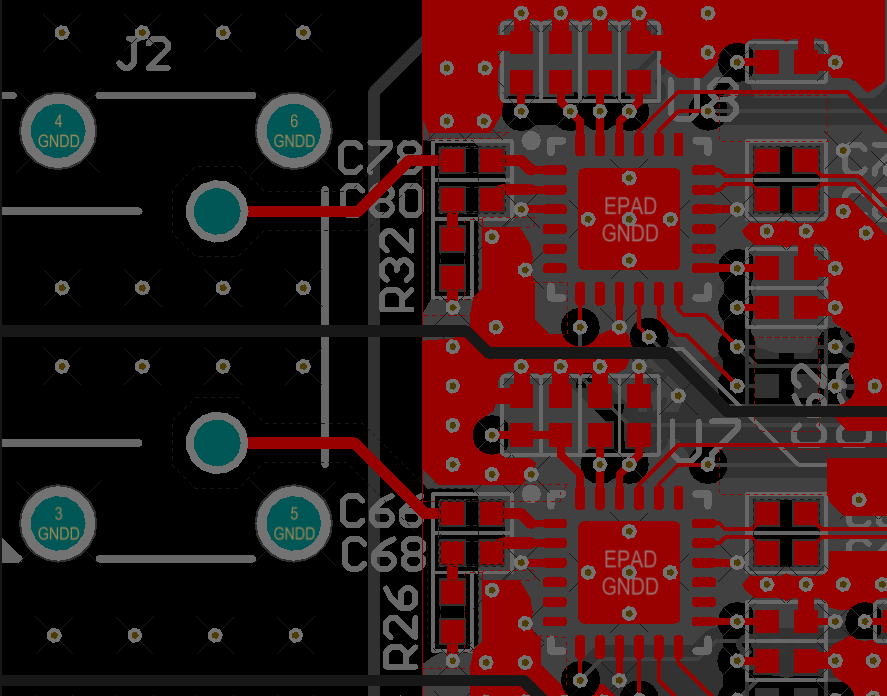

After consulting with other nearby engineers with experience in 12G-SDI and electromagnetic field solver, we'd found serious issues with our PCB design:
For testing, we made some hardware modification (warning: this photo may not be appropriate for some engineers):
And this helped a lot - now we are able to stable receive 12G-SDI video from several different sources (including Phabrix Qx) using both long, short, even 4GHz-rated cables. Our modified output is also accepted by converters and analyzer (perfect jitter, complaining about bit slow edges). However, loopback with short cables (< 2m) is still issue - I believe that drilled hole and hand-soldered wire isn't perfect for 12GHz.
So, now, we've redesigned our PCB using electromagnetic field solver:
Hope this time we'll have no issues, will respond when PCB will be fabricated

Reviewing your new pcb layout BNC anti-pad, there are some comments:
1). Return loss/TDR measurement should show this as well. It might be a good idea to do these measurements - using your field solver - with the old and new pcb layout. First to make sure you can see the problem and then secondly the new layout takes care of the problem.
2). Please check with your BNC connector vendor. They should provide you with the optimum anti-pad or pcb layout for the connector.
3). Given your new pcb layout that you have shown above, i am wondering if cable driver may cause some imbalance on the EQ unused input? This could be like cross talk where it may affect your long cable reach. Is there a way to check this with your field solver?
4). If you like, please send me your new pcb layout for review. Is this available in .brd Allegro from Cadence or if this is not available please send me your gerber.
