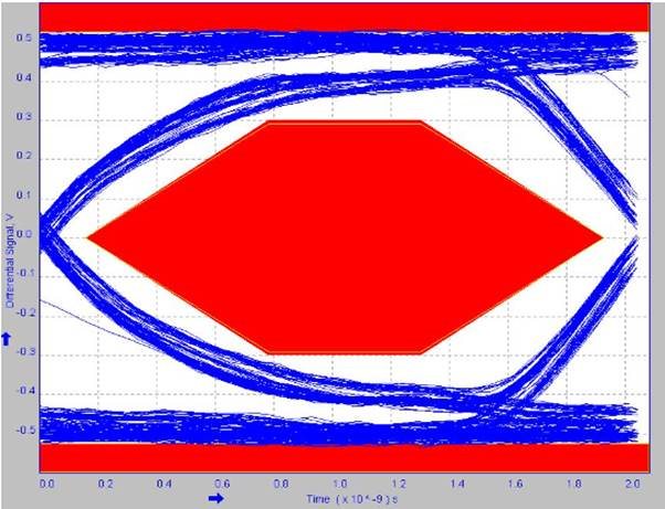

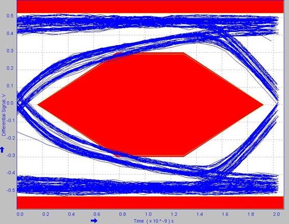

Hello expert,
My customer would like to know if we have a chance to improve the eye diagram after signal pass TS3USB221E. Eye diagram is shown below. Thanks a lot!
BEFORE IC
AFTER IC
Ann Lien
  • Hi Ann,
    In this case a USB 2 redriver may need to be used, devices like TUSB212 and TUSB217 should work your this. TS3USB221 is only a passive mux and only has ability to improve signal quality. There may be settings on your USB Host that could increase swing and help open the eye diagram.
