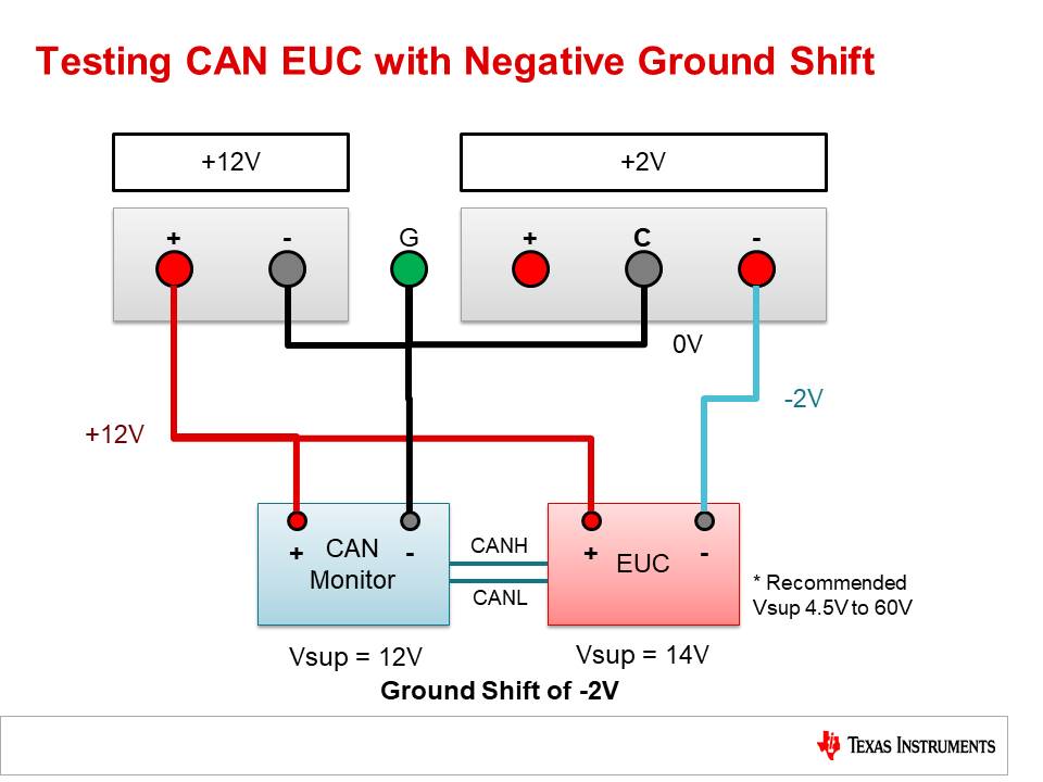

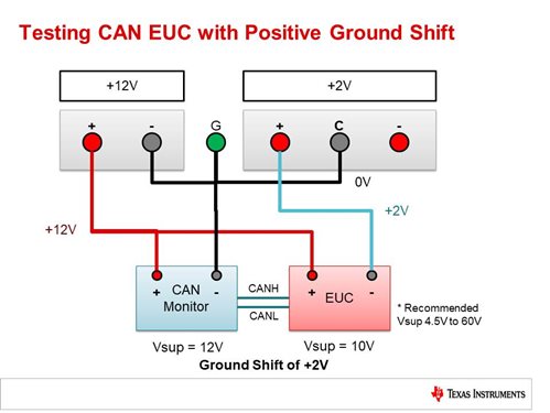

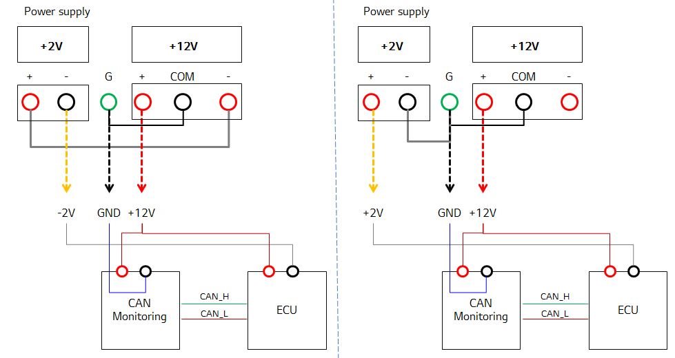

I want to Ground shift test of can bus
Can you share me the connection diagram for the test?
How can I make a groung shift condition?
 - When the DUT reaches the ground offset 2V, it must maintain normal communication behavior, and can correctly send and receive bus messages
 - When the DUT reaches the ground offset of - 2V, it must maintain normal communication behavior and can correctly send and receive bus messages
I see similar results in the below link
www.ti.com/.../slla337.pdf
