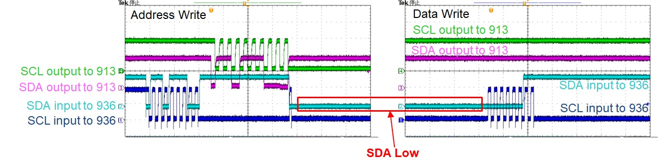

Accessing the camera with a I2C remote slave in the configuration of DS90UB936-Q1 to DS90UB913-Q1.
- What is the maximum time for clock stretching for I2C remote slave?
- The waveform below shows address writing and data writing.
  During that time, the SDA input to the DS90UB936-Q1 goes low. Is this low a problem?
