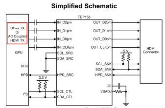

  • Hi sir,
    The TDP158 device is an AC-Coupled HDMI signal to transition-minimized differential signal (TMDS) Redriver supporting digital video interface (DVI) 1.0 and high-definition multimedia interface (HDMI) 1.4b and 2.0b output signals.
    The input of TDP158 can be DP++ TX or AC coupled HDMI TX.
    The input application of SN75DP139 is the same with the input of TDP158???
    Please help to confirm it.
    thanks
  • DP139 is a AC-coupled HDMI1.4 level shifter re-driver.
    DP158 is a AC-coupled HDMI2.0 level shifter re-driver.
    DP159 is a AC-coupled HDMI2.0 level shifter re-timer/re-driver.
    Both DP139 and DP158 support AC-coupled HDMI, but at different data rate.
