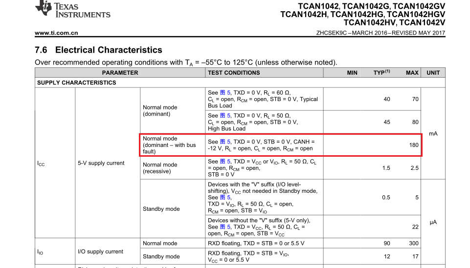

For input current Icc of TCAN1042, we give a 180mA at dominant with bus fault condition.
from the spec, this Icc current would appear with CANH= -12V? Customer wants to know why we define this spec?
Because, the maximum BUS voltage range is +/-58V(with 'H suffix).
Dose it mean the Icc current would increase with higher bus voltage but IC would not damage within +/-58V?
For normal application, we only need to consider 80mA maximum supply current. is it right?
Thanks.
  • Oliver,
    The specific parameter is a worst-case condition where the battery voltage in a vehicle is reversed, and the bus is shorted to it while the bus is driven dominant. It is a very rare condition, and it's to show the current-limiting in case that worst-case situation occurs. It is sized to 12V since that is the standard voltage for a car battery, and CAN's primary applications are in automotive vehicles.
    For normal application, yes, you only need to consider 80mA.
