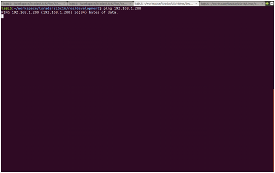

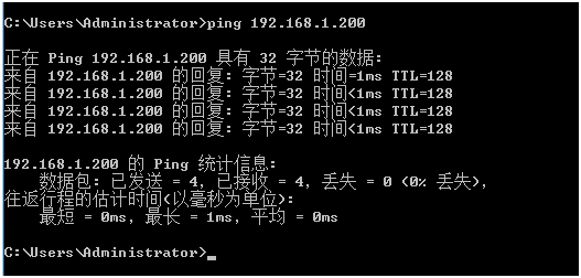

use our DP83867E PHY, ping command is useful in WINDOWs system, but no response in Linux system.
windows system PC
LINUX SYSTEM PC

Hello Maka,
Can you please take a look at this https://e2e.ti.com/support/interface/f/138/p/574543/2108603 and let me know if the solution presented there does not solve your issue?
