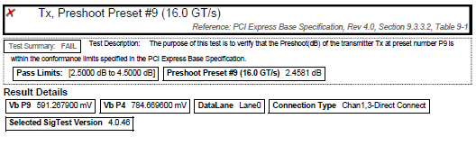

  • If I set the VOD = 3.
    I will fail with TX Preshoot Preset #9
  • Hello-
    As mentioned before, the DS160PR410 linearity is not ideal as it is true for any linear redriver.  It slightly attenuates PCIe TX pre-sets (that is, it reduces TX equalization).  However, it also adds significant RX equalization (up to 18 dB), so the benefits of a redriver a more than justified.
    With VOD=3, you fail P9 by less than 0.05 dB.  You have the following options:
    Option 1: Reduce VOD to 1 or 0.  With reduced VOD, the redriver linearity improves, so TX equalization improves by a fraction of a dB, however, you reduce the signal amplitude by -3.5 dB or - 6 dB, making it difficult to pass other TX/RX equalization tests, plus your overall system noise margin is reduced.  This option is not recommended.
    Option 2:  See if there is a way to slightly increase TX Equalization of your PCIe device by 0.1-0.2 dB.
    Option 3:  Waive the failure.  The 0.05 dB of TX equalization is insignificant compared to the RX equalization added by the re-driver.

  • Hello Edward,
    The P9 pre-shoot spec is 2.5 dB to 4.5 dB.  You reported 2.4581 dB.  This is less than 0.05 dB below the min spec of 2.5 dB.  From the system performance point of view, this is insignificant.
    The DS160PR410 passes all PCI-SIG compliance tests, however, for the TX preset tests, we had to select an endpoint that passes the TX preset tests by itself with good margin.  For example, if a PCIe TX has a 2.7 dB P9 preshoot, the AIC would likely fail the test with the redriver in the data path. A PCIe TX with a 3 to 3.5 dB P9 preshoot would be ok with the redriver in the data path.
    Changing CTLE setting does not significantly impact redriver linearity.  So, with VOD=3, increasing CTLE will likely not help with the pre-set test.
    Davor

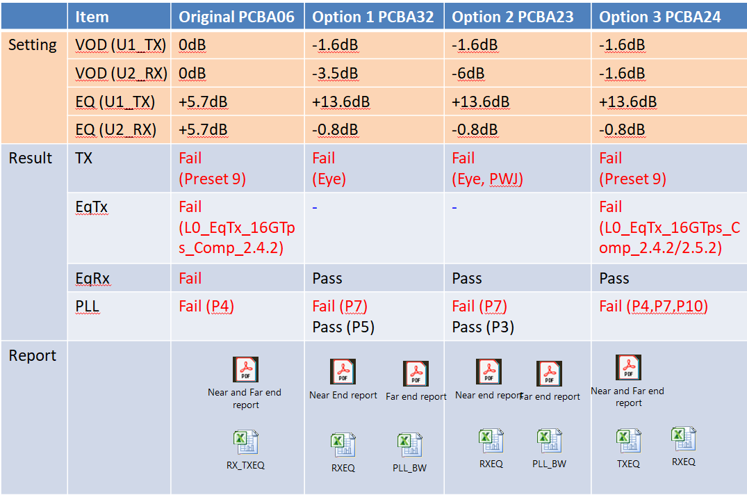

  • Hello Davor
    I correct the test result as below
    And based on the results of these days of discussions, next plan as below.
    Can you help confirm if there are other suggestions for the next test plan?
    Can we send AIC and DUT or do we go to TI USA to test PCIe SIG compliance test and CTLE optimization?
    Ti have PCIe Gen 4 test lab on the Taipei office?
    BR
    Edward
  • Hello Edward,
    During the TX preset testing, the TX preshoot (P9) is going through the redriver U2. Correct?  So, we are reducing VOD on U2 to Index =1 (-3.5 dB) to improve the linearity of the redriver and help pass the P9 pre-shoot test.  The VOD on the redriver U1 should always stay at Index 3 (0 dB).
    I'd suggest the following options:
    VOD (U1_TX)= 0 dB
    VOD (U2_TX)=-3.5 dB
    EQ (U1_RX) = 13.6 dB may or may not be optimal setting.  Try also 10.7 dB and 7.1 dB.
    EQ (U2_RX) = -0.8 dB may or may not be optimal setting.  Try also 1.3 dB and 5.7 dB.
    If necessary, please arrange on-site help from your local TI FAE.
    Davor

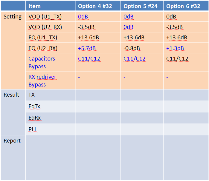

    And about you suggestion we update the test plan as below
    BR
    Edward
  • Hello Edward,
    Your results so far allow us to conclude that we should use the following VOD settings:
    VOD (U1_TX)= 0 dB
    VOD (U2_TX)=-3.5 dB
    As mentioned before, VOD=0 dB is a recommended setting and provides the highest eye opening.  We only adjust it down if we see TX Preset failures.
    The remaining items are to see if the  EQ settings could be optimized further.  In general, EQ settings should be optimized based on the channel loss and the expected PCIe TX preset.  For example, if the channel loss between root complex PCIe TX  and redriver RX (U1) is 20 dB, assuming PCIe TX would normally operate with P8 (~7dB TX EQ), the redriver RX EQ should be set to ~13 dB.  This would be a good starting point for fine tuning.  From here, you should sweep the redriver RX EQ up and down to see what gives you the best eye opening for that specific channel.
    Similar approach should be done on the channel between the endpoint PCIE TX  and the redriver RX (U2).
    Also, let's take the discussion about sending your board to TI USA offline.  Send an email to Ben Kuo (TI FAE) and ask him to loop me in.
    Davor

  • Hi Davor
    Will retest below setting at our vender lab on 1/13.
    Did your have any suggestion about the setting.
  • Hello Edward,
    VOD (U1_TX)= 0 dB
    VOD (U2_TX)=-3.5 dB
    EQ (U1_RX) = 13.6 dB may or may not be optimal setting.  Try at least 10.7 dB and 7.1 dB.
    EQ (U2_RX) = -0.8 dB may or may not be optimal setting.  Try at least 1.3 dB and 5.7 dB.
    Davor
