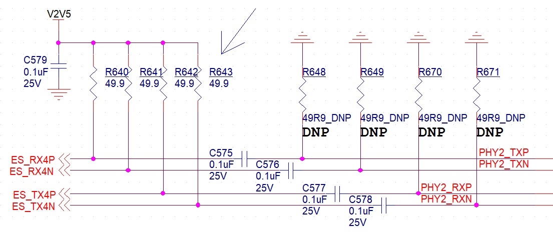

Hi experts,
I have a design using DP83867CRRGZ, while I have to connect it with another PHY directly, meanwhile the area in my board is very limited, so I have to use AC coupling mode to connect them together.
For DP83867CRRGZ, when I connected it with transformer, the center tap pin will be connect with GND by a 0.1uF, as for the other PHY, when connected with transformer, its center tap must be 2.5V, meanwhile it's 100M Ethernet, so I only use two pairs of signals.
What's the key for connecting two PHY connected, is it the common voltage? as the signal will be compatible with IEEE spec, is that right?
Back to TI PHY signals, current there is no pull-up/down for them, can this be feasible? Is there anything I missed?

    Can you provide a more complete schematic? For best performance with the DP83867, we recommend not using AC coupling. The differential pairs do not need pull-ups.

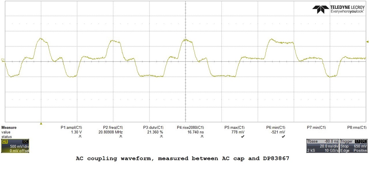

    Please refer to below for a more complete schematic, I have been using DP83867 in a bunch of projects, so I think the schematic design should be fine. The main reason I wanted to use AC coupling is the limited area available in my board, meanwhile I'm also using 100M Ethernet.
    I also made rework to one of my current board, and measured rx waveform in DP83867 RX side, which should be port B. I think it should be fine, I also verified that the "Ping" and "DHCP" can work. I want to get more professional input from TI, in case I miss something.
    Chris
  • Hi Chris,
    This is a unique application and we have not tested this in regards to the IEEE spec compliance. You are correct, there should be no pull ups on the DP83867 signals. As far as requirements for connecting the other PHY, is this other device a TI PHY? If so, the datasheet will explain implementation of back-to-back mode. If the other PHY is not a TI device, please contact the manufacturer for requirements of back-to-back configuration.
