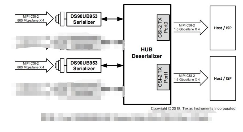

HI,
Does DS90UB953 support this work mode?
Best regards
Kailyn
Hello Kailyn,
The intent is to send each 953 camera to one SoC host? Or to replicate both camera's data to both SoC hosts?
Casey
Hi Casey,
The customer's intention is to send each 953 camera to two host, that to to say, camera 1 to host 1, camera 2 to host 2?
I find this post is similar to this question, but the customer use DS90UB936 instead of UB954, so I am not sure if UB954 also doesn't support this mode.
Hi Casey,
I am sorry that the HUB deserializer is DS90UB960 not UB954.
That is to say, if the camera0 data could send to CSI2 Port0 and camera1 data send to Port1?
Hello Kailyn,
Yes this is possible and it is described well in 960 datasheet section 7.4.25
