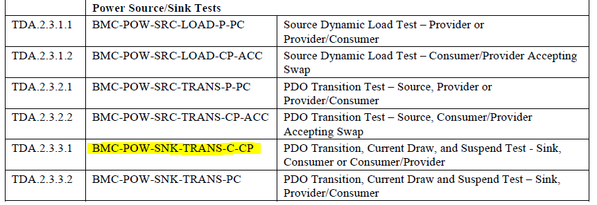

Customer feedback they have only one fail on test ID TDA.2.3.3.1 POW SNK TRANS C CP.
Is this test equipment issue?

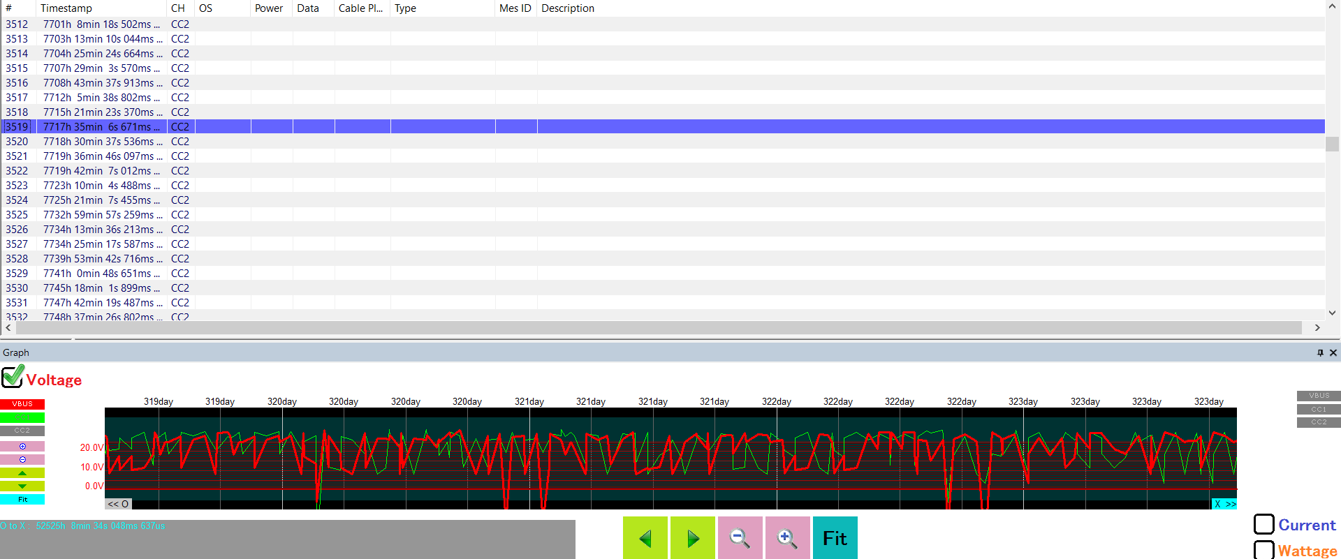

The waveform from log is strange.

  • Hi Shaq,
    What GRL hardware and software version is used for this?
    Can you attach the GRL log file with summary and trace files (this can be done by zipping the entire output directory). The attached log does not have the failure information.
