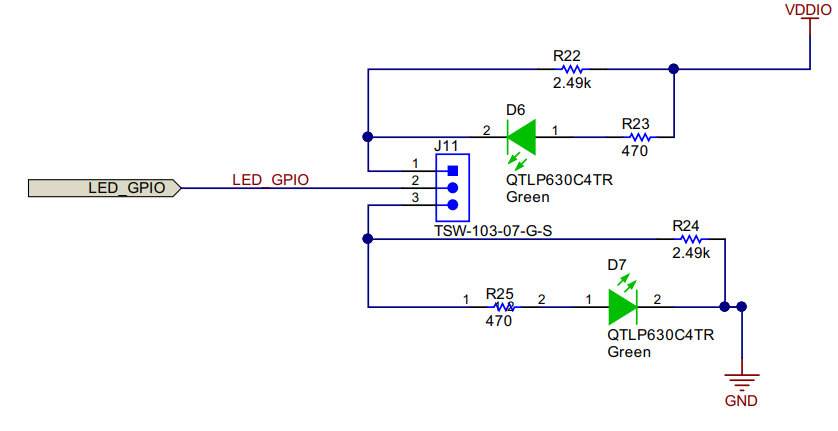

<Question1>
In relaion to following forum, we have the question of pull up or pull down at LED_1 pin in case of boot strap setting.
e2e.ti.com/.../2775945
We recognize that LED_1 needs pull resistance to configure MODE1 and MODE4.
"It is a strap pin, but the pin is for internal use only. This is why the pin must be strapped to either MODE1 or MODE4. MODE2 and MODE3 are not allowed."
In oreder to configure MODE1 and MODE4, we would like to confirm resitance setting in case of using LED.
LED_1 pin has internal pull down. So, on following DP83822 EVM circuit,
J11 1-2 short : Mode4
J11 2-3 short : Mode1
Is our recognition correct?

  • Hi Hirotaka,
    For questions 1 and 2 you are correct.
    For question 3: Yes, you may configure LED_1 with LEDCFG1 register to overwrite the default startup setting. And yes you should also change register 0x0462 as you have mentioned.

    In relation to <Question1>, we would like to confirm one point.
    "It(LED_1) is a strap pin, but the pin is for internal use only. This is why the pin must be strapped to either MODE1 or MODE4. MODE2 and MODE3 are not allowed."
    ->We recognize that MODE2 and MODE3 are not allowed at LED_1's boot strap setting, we should configure MODE1 or MODE4 also.
       What is the difference between MODE1 and MODE4?
       As the background of this question, the customer would like to know which the setting MODE1 and MODE4 are better.
    Kind regards,
    Hirotaka Matsumoto
  • Hi Hirotaka-san,
    MODE 1 and MODE4 are considered "Do not care's" and there is not one that is better than the other. The customer may use either.
