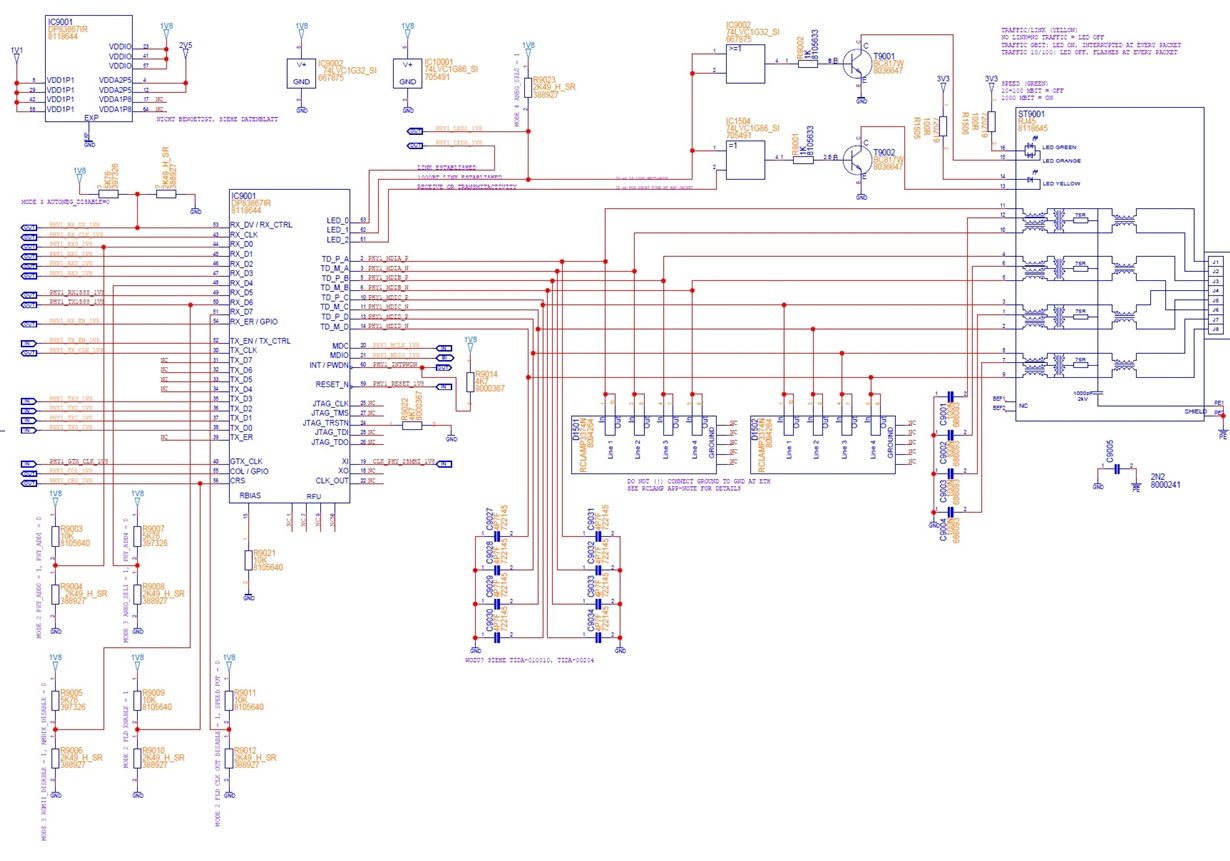

    Can you please share you schematic with me?
    Thank you,
    Nikhil
  • Hi Nikhil,
    Below is my schematic, RBIAS was already changed to 11k:
  • Hi Stefan,
    We tried to reproduce this issue in the lab and have seen that TX Clock is functional after writing 0 to register 32. Once I set register 32 to 0, I see TX Clock enabled. How are you accessing the extended registers. Can you read back register 6E and 6F upon power-up, before making any other software changes? These registers indicate what strap modes the PHY has been set to, so we can compare with the schematic. Additionally, please read registers 32 and 31 upon power-up , before making any other changes.
