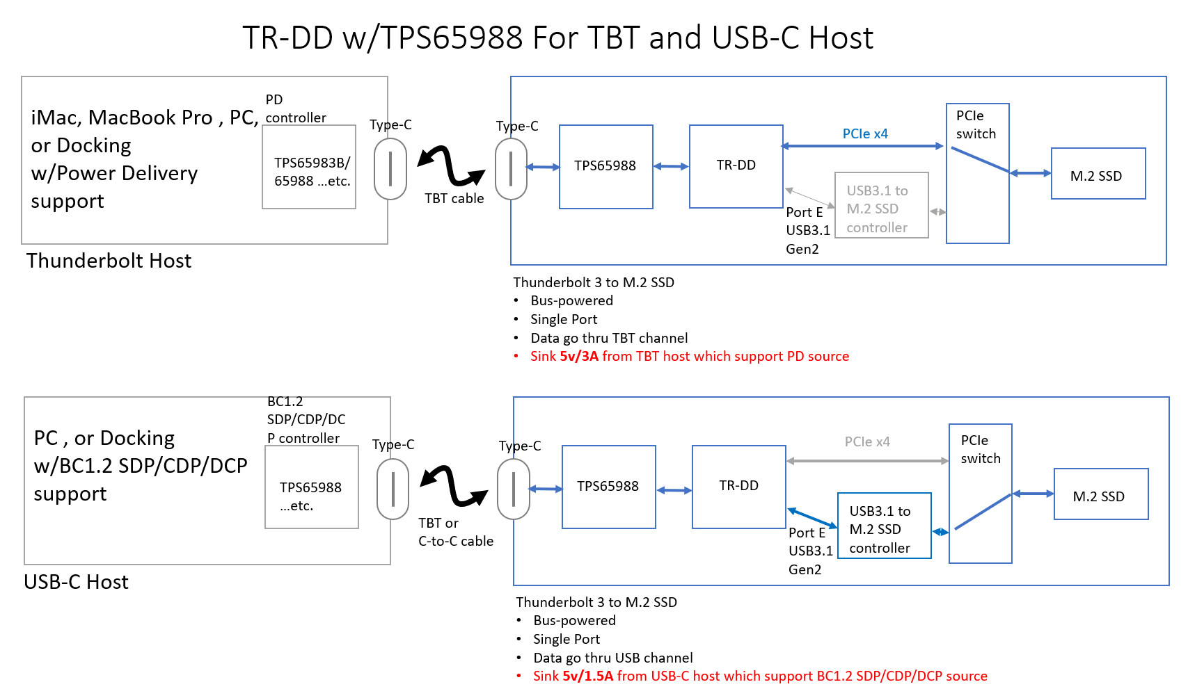

Hello, This is Sam from Ekozy Taipei, Taiwan,
We would like to use TPS65988 + Intel Thunderbolt Titan Ridge-DD for portable device, bus-powered application.
TR-DD can work with host TBT type-C or USB-C , the TPS65988 acts as a TBT PD sink,

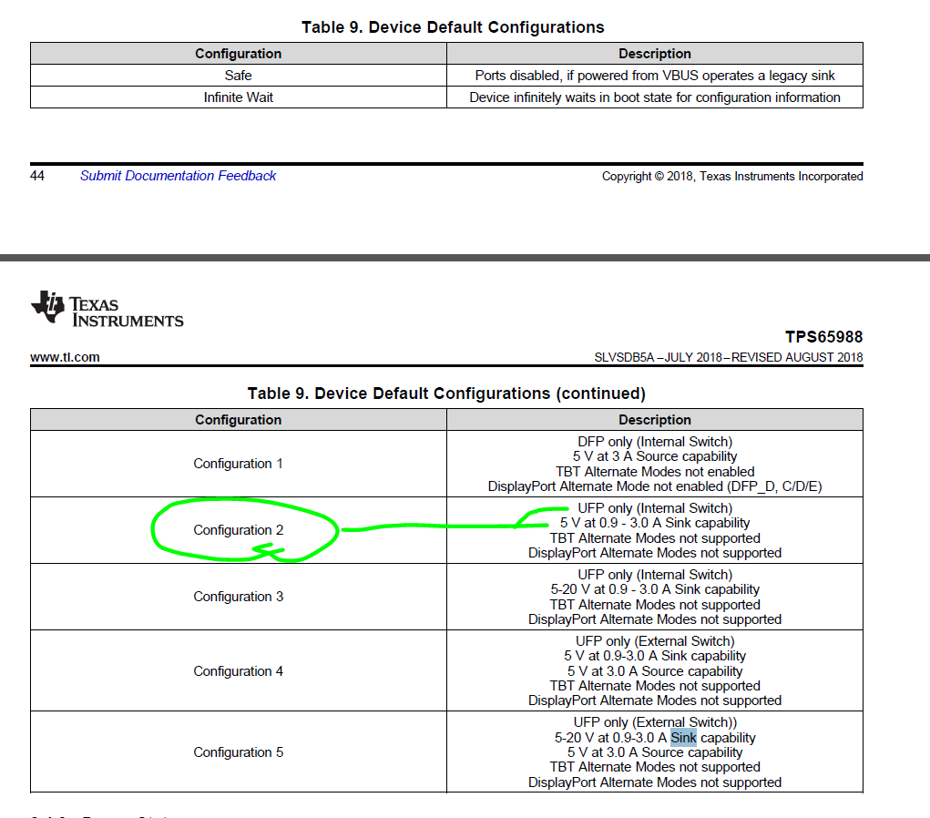

When the host or docking USB-C port support BC1.2 SDP/CDP , my question is that TPS65988 can be a BC1.2 SNK (sink) to sink power 5v/1.5A from host/docking to power our PCBA.
Yes, our PCBA will control power consumption within 7.5Watt(5v/1.5A).
I saw the data sheet (as below) , to set the "configulation 2" looks like to meet our requirement.
