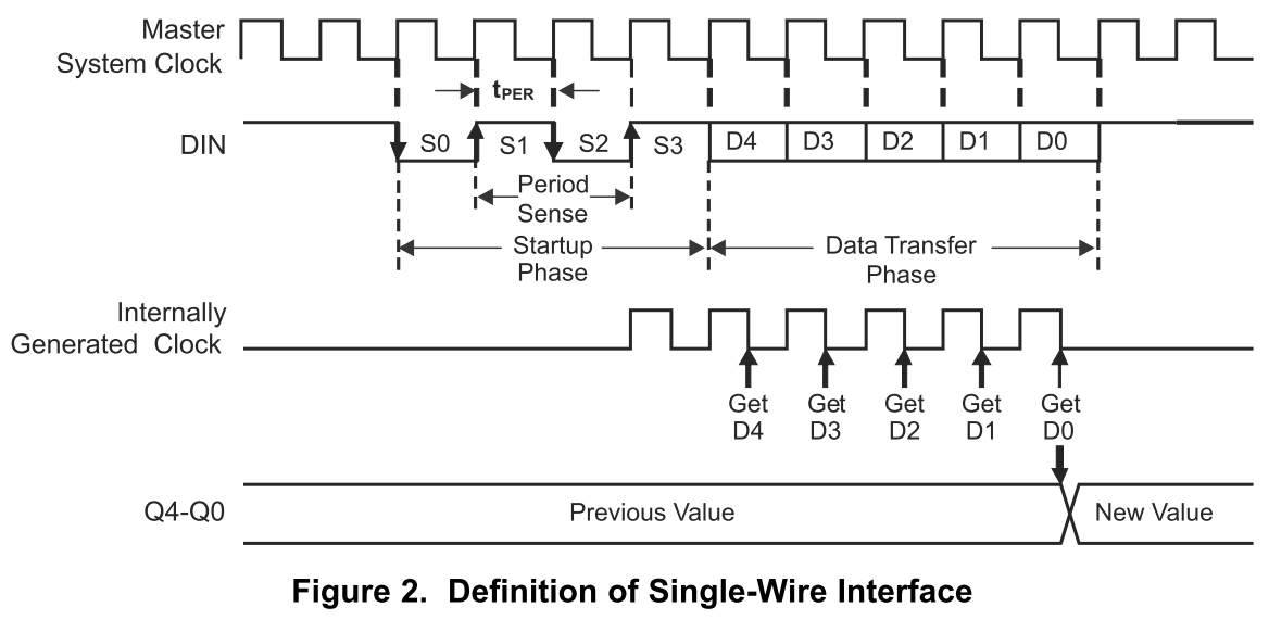

Hi Team,
Customer want to use TCA5405 in their products. They get two points about TCA5405 want to confirm with you:
1. The previous value would keep all the time, if there is no refresh of it and the supply power is stable, does this correct?
2. If the previous and the new value are the same, the waveform be stable, no glitch, does this correct?
Hope you could give some comments.
