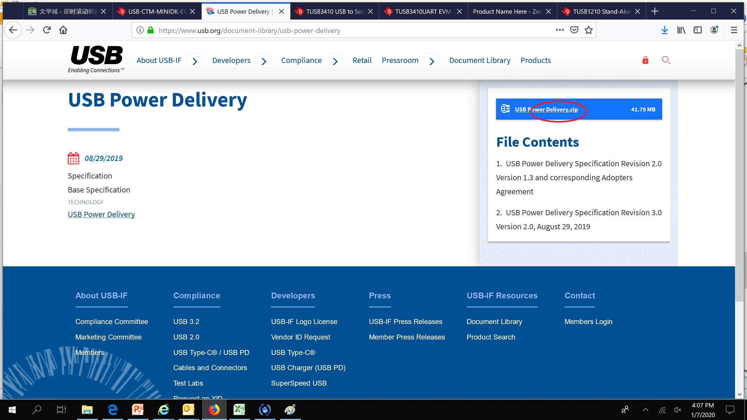

we have done it, need clarification on 7.4.3, in that on 4.th point, what is PS_RDY, please give description for this
thanks
8535.tusb422.pdf8.3.2.2. portion itself is not available, please provide the right datasheet
