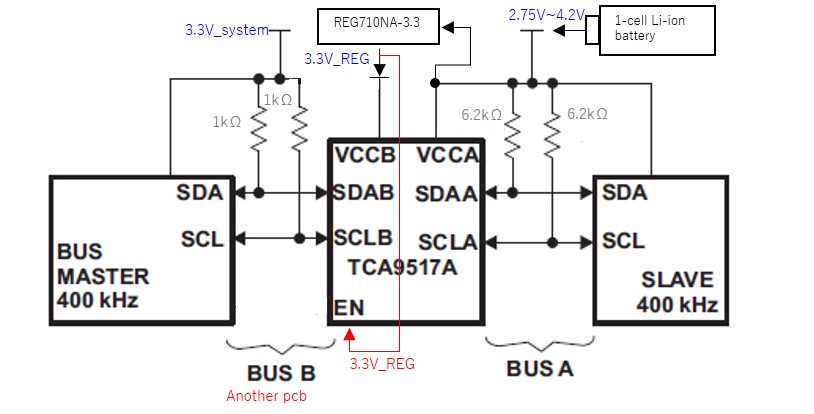

I am considering using the TCA9517A with the following configuration. Is there a problem with my usage?
Also, In my circuit, is VOL less than 0.6V under any condition?
(About variations such as differences between LOTs, individual differences, temperature..)
Please comment if you have any concerns.

    Your set looks like it can work. I would suggest placing a pull down resistor on the EN pin and when you connect the left PCB to the right PCB, the master should still be holding the enable to GND for a little before SDA/SCL on B side connect and pull high. After that you can drive enable high. Alternatively, you can make the enable pull down really weak and use an RC constant to pull the enable high with apull up on the left PCB such that the rise time is within micro/milli-seconds
    You'll also need to ensure you have common GND between the two boards.
    -Bobby

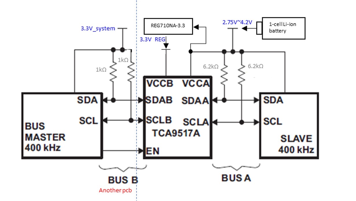

    There was a mistake in the configuration I attached.
    I will attach the modified circuit. (I modified the EN connection.)
    I assume that EN connects to the output of REG710 just like VCCB.
    Even before the Master wakes up, the Slave wakes up.
    Is this a problem?
    Please let me know the recommended constant of the pull-down resistor.
    GND is common to the two PCBs.
    (Connected to the GND of the Li-ion battery.)

  • user4522287 said:
    Thank you for your reply.
    Is this a problem?
    [Bobby] I do see a potential problem since VccA and VccB can both be powered up with EN pulled high but B side pull up resistors may not be present. You could have a situation where B side is floating since the pull up resistor looks like it is supplied by another PCB (pull up named 3.3V_system). You may want to have the EN pin be referenced to GND until it connects to the master PCB.
    [Bobby] You mean pull up resistor correct? This depends on communication speed and expected bus capacitance. We have an app note to calculate this here: http://www.ti.com/lit/slva689
    As you say, the B side may float.
    What are the risks if the B side is floating?
    I think that there is no problem because I put the initialization process of I2C communication when the master starts up.

     [Bobby] Icc would likely increase due to the input stage of the device floating. This would affect applications which rely on a battery. The second problem is if the input floats low, it could pull SDA/SCL low on the slave side. This could generate a start condition and get the slave's state machine into a stage where it thinks there is an I2C transaction going on. Though the possibility is low, it could also see it's own address and a read/write bit.
    I want to know the recommended constant of the pull-down resistor for the EN pin.
     [Bobby] I think the internal pull up on En is in the order of 80k or so (highest being 100k and lowest probably around 60k). You would need the voltage to be less than 30% of VccB to register the enable pin as a low. In the case of 100k, R pull down would need to be 42k or less. In the case of 60k, R pull down needs to be 25k or less. The worst case would be 60k so i would suggest 20k for a pull down.
