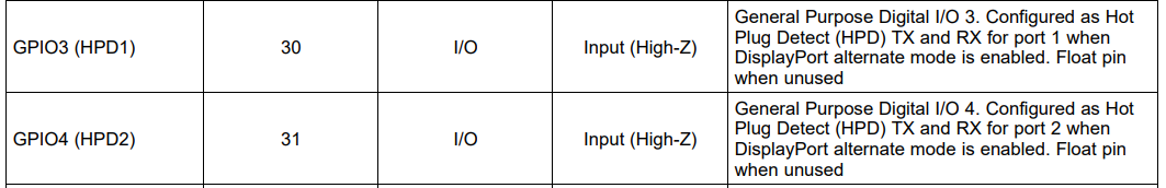

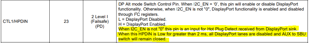

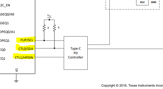

Hi Team,
My customer is using TPS65988DJ + TUSB1046 as solution for docking station application,
if customer using PD's I2C to control TUSB1046, in this case, when TUSB1046’s I2C_EN is not 0(not use as GPIO mode) , the CTL1/HPDIN pin will act as Hot Plug Detect Input(HPDIN) and needed to connected to PD(GPIO3 or 4 depend on which port is used for TUSB1046), and HPDIN/RSVD2 is reserved .
Is my understanding correct?
