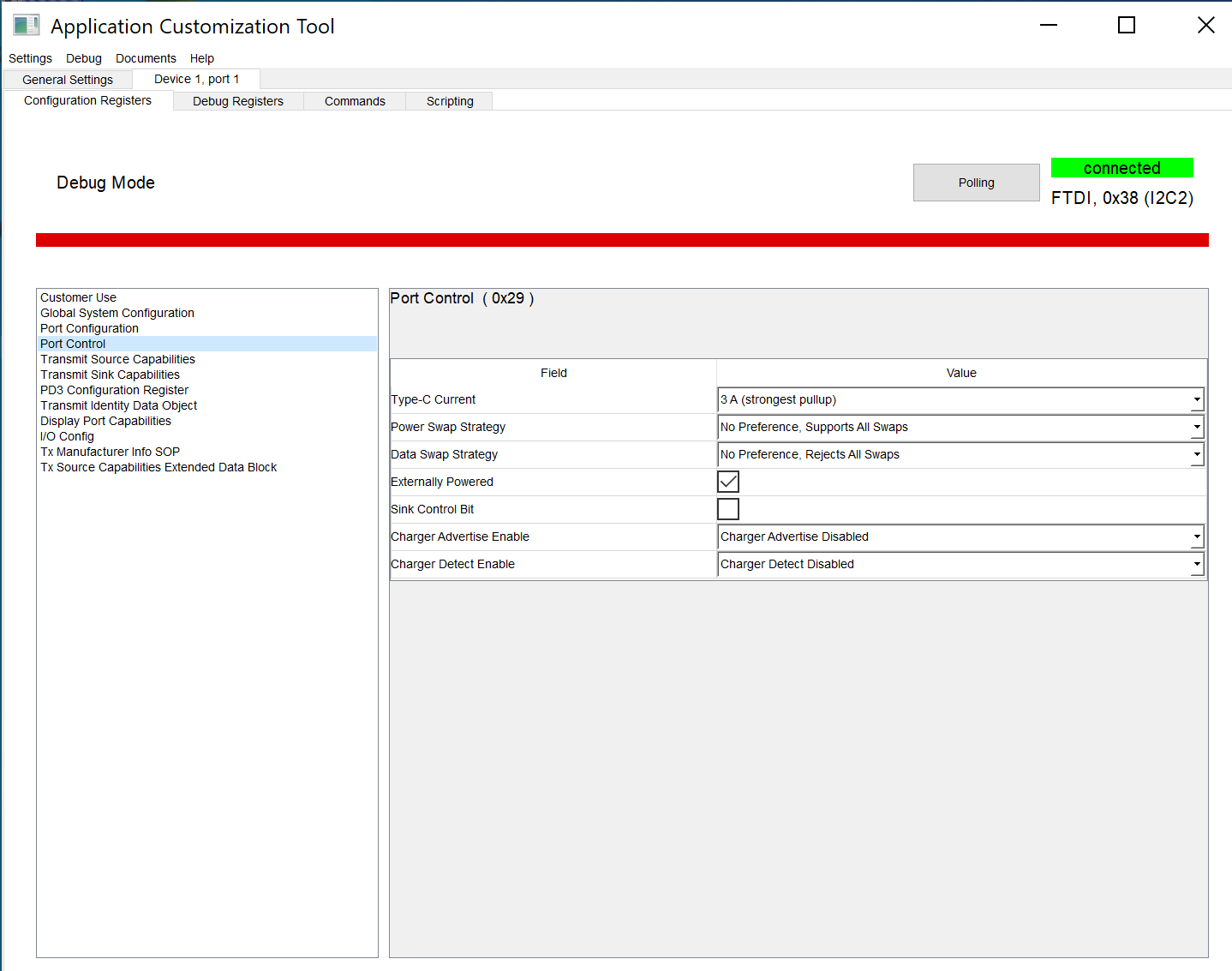

I'm using TPS65987D with 2 modes: UFP & DRP at 2 different scenarios. As the board does not have its own power source, the device is configured as UFP (dead battery mode) when it's first connected to a phone. It relies on the phone power to power on the board. When another external power source is applied, we want the TPS65987D to do a PD PR_Swap to source in order to act as a power source to the phone (i.e. charging the phone). The problem is, as soon as the swap occurs, there is little current going to the phone which causes it to output a message "device is slowly charging ..".
Before the swap, the TPS65987D was set up with appropriate values to registers: Tx Source Capabilties (addr 0x32), Port Config (addr 0x28) as DRP, Port Control (addr 0x29) as initiateSwapToSource.
The current draw from the phone is very low (~150 mA) via a USB-C connector.
Can you point out what I might have been missing?

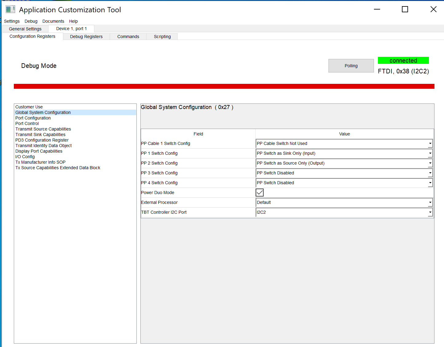

  • I'd like to update a few facts:
    PP1 is used as power path as a sink (from VBUS to PP1HV)
    PP2 is used as power path as a source (from PP2HV to VBUS)

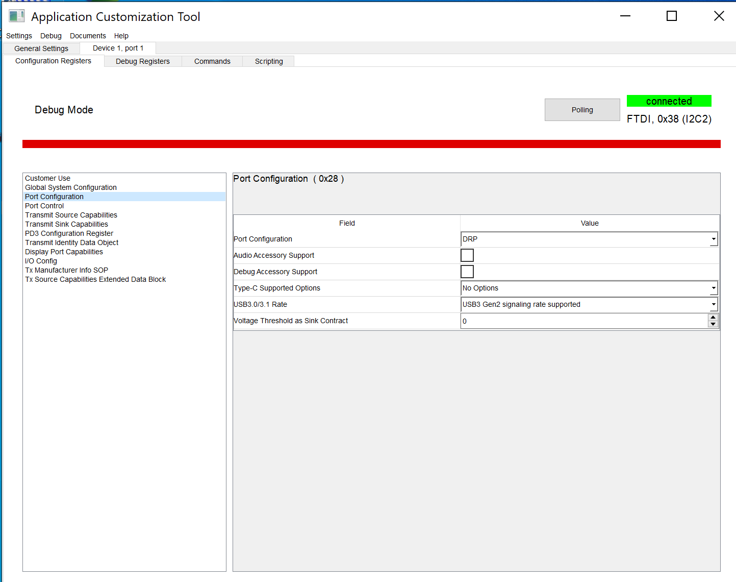

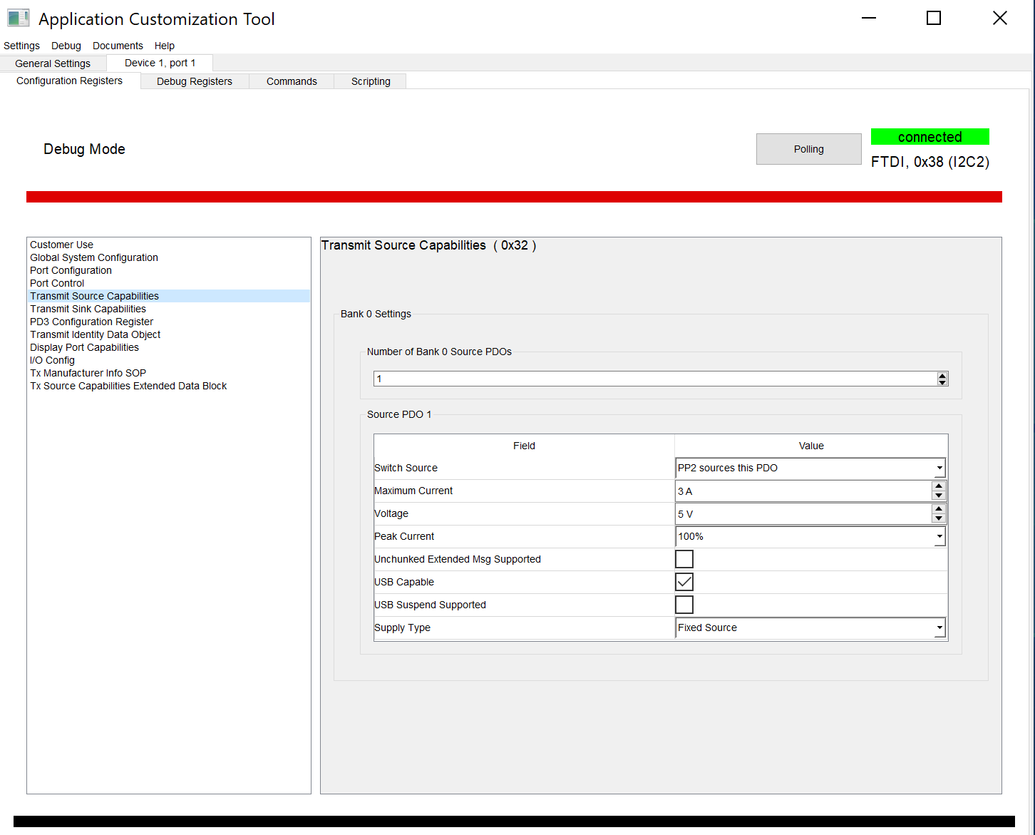

    Yes. The following programming (by a MCU host via I2C) was done right after dead battery boot process with power source coming from the phone:
    1. clear dead battery flag (write to to CMD1 reg with 4CC string 'DBfg') - and yes I did verify it was clear by reading register 0x2D afterward.
    2. write to Tx Source Capabilities reg 0x32 with value:
    0x0190000000000000000000000000000006412c0004b12c86e0b12c0101912c000000550000FC02
    (this may be not necessary as the device still acts as a sink in this mode, but it was set up to prepare in advance when it becomes a source later)
    After an external power source was applied (via another USB-C receptacle with 5V), the following programming steps were done in order:
    3. write to Port Config reg 0x28 with value: 0x0000000000000119 (key point is changing to DRP state machine)
    4. write to Port Control reg 0x29 with value: 0x00290082 (InitSwaptoSource)
    After step 3, the USB connection to phone is lost. After step 4, the power swap appears to take effect as the phone starts seeing signs of incoming charging as follows:
    a) brief flashing screen and then charging icon show up
    b) message prompts with "Device is slowly charging .... use the charger that comes with manufacturer is recommended"
    In reality, the USB connection is lost and the phone draws very little current. We measured the total consumption at the input where the external charge was applied, the current is only 150 mA (including the board and the phone, if it draws anything at all).
    We expected that, after the power swap, the phone would become a sink while still maintaining data host (DFP) whereas our board would becomes a source while retaining data role as UFP, just like before the swap.
    Can you please help pinpoint what went wrong with my set-up?

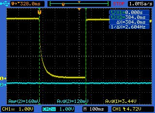

  • Hi Prajith,
    I changed to the patch loading programming flow following the app note. Unfortunately, the behavior was the same.
    The power swap appeared to occur as I observed the following symptoms:
    1. The phone app showed the change from output current (-300 mA) to input current (200 mA), which is very little (the app name is Ampere)
    2. The output voltage from our board to the phone (VBUS) is only 4.2 V (a change from input voltage of 5V from the phone)
    3. The transition from 5V input voltage (from the phone) to 4.2 V (from the internal PP2 switch) is INTANSTANEOUS
    Compared with the behavior from the EVM module:
    1. The phone app shows 1100 mA a
    2. The VBUS voltage is ~5V (also from internal switch PP2)
    3. There was a gap of 384 ms of the transition from input voltage to output voltage (5V -> 0V (384 ms) -> 5V)
    The 2 waveforms are attached.
    It appears that in my case there is something strange that makes the power switch PP2 not behaving as it should. It's not the problem of a specific chip as I tried on all the boards and they behaved the same way.
    Can you think any possibility that cause this behavior? Do I need a firmware patch on the chip possibly?
