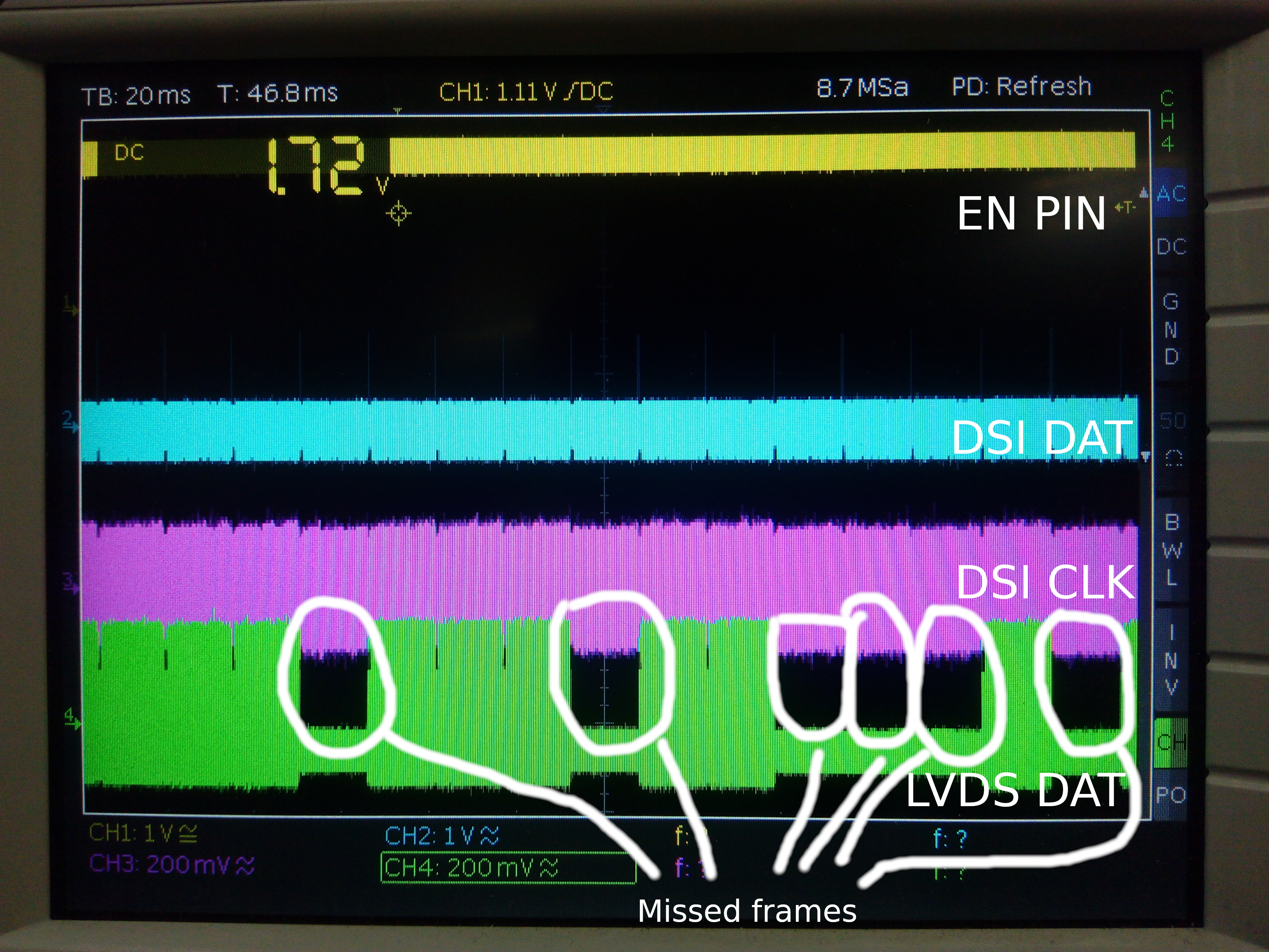

Hi, I'm trying to write linux driver for SN65DSI84. I use this files as example.
DSI:
lanes = 4,
format = RGB888,
clock = 280 MHz
display-timings (from device tree):
timing0: timing0 {
clock-frequency = <70000000>;
hactive = <1024>;
vactive = <768>;
hback-porch = <160>;
hfront-porch = <24>;
vback-porch = <29>;
vfront-porch = <3>;
hsync-len = <136>;
vsync-len = <6>;
hsync-active = <0>;
vsync-active = <0>;
de-active = <0>;
pixelclk-active = <0>;

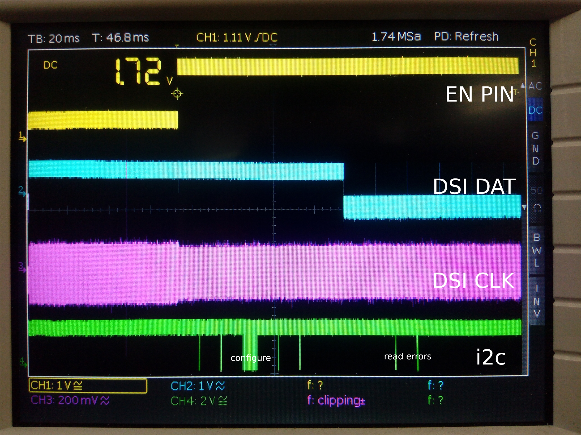

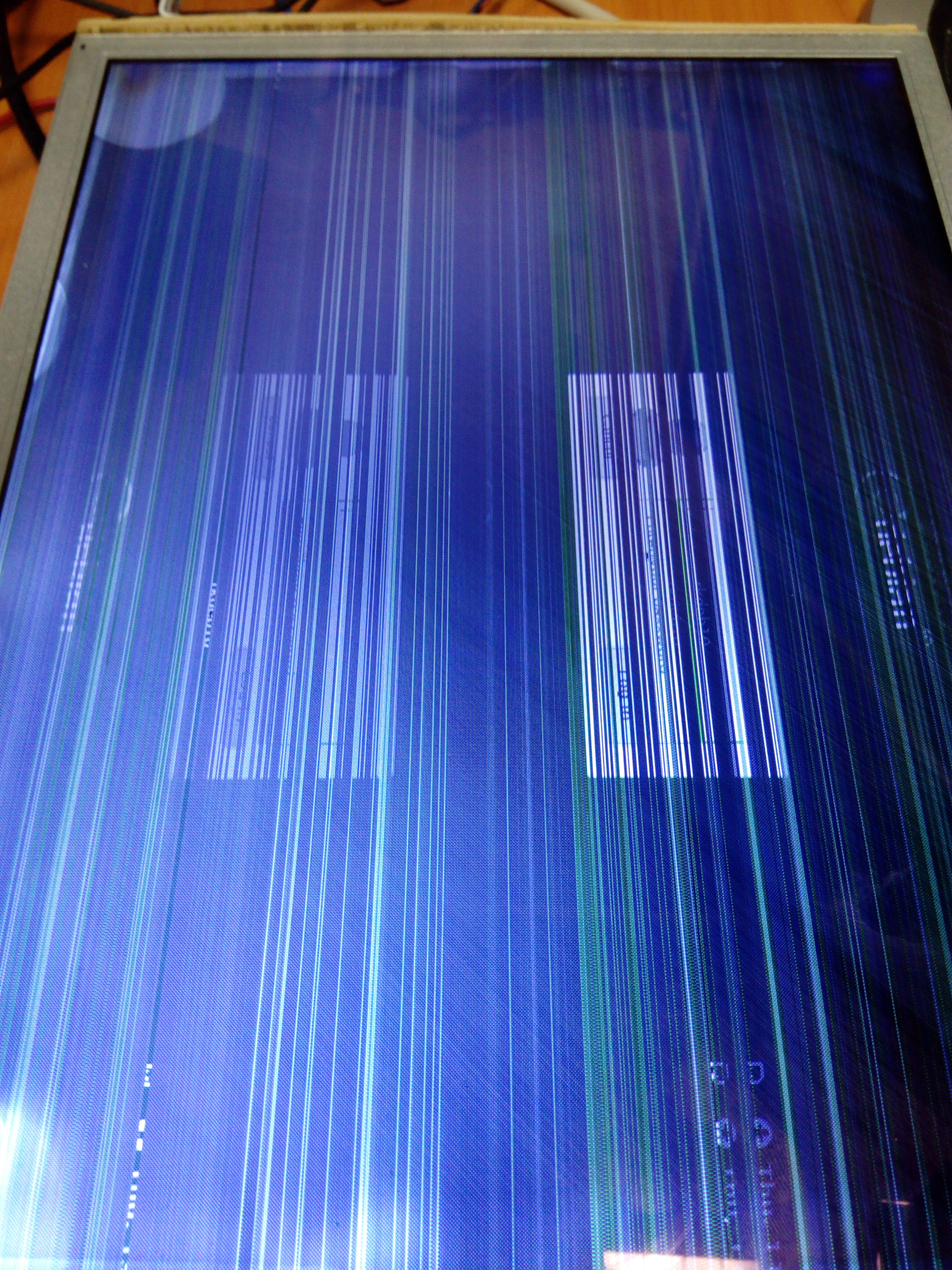

I set DSI_CLK_DIVIDER to divide by 4 (LVDS clock = 70 MHz)
Test pattern work fine, but for real DSI signal I have an errors. Register 0xE5 bit2 and bit3 (CHA_SOT_BIT_ERR, CHA_LLP_ERR).

i2c_smbus_write_byte_data(client, DSI85_PLL_EN, 0x01); // init seq 6
mdelay(10);
i2c_smbus_write_byte_data(client, DSI85_SOFT_RESET, 0x01); // init seq 7
mdelay(10);
// clear errors
i2c_smbus_write_byte_data(client, DSI85_ERRORS, 0xFF); // init seq 10
mdelay(10);
i2c_read = i2c_smbus_read_byte_data(client, DSI85_ERRORS); // init seq 11
