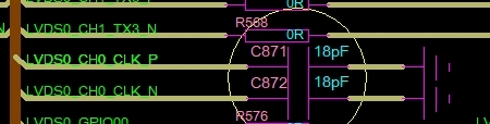

Hi Team,
As we know, sometimes in order to improve EMI performance, consider adding a small capacitor at both ends of CLK +/- like the below picture, which will also slow down the clock's raise time and fall time.
So I want to confirm what are the requirements for the raise time and fall time of 947? Or how to determine the value of this capacitor? Thanks.

    If you did want to control the rise/fall time, would it not be easier from the processor side? Nevertheless, We don't have a special requirement for the rise/fall time. In terms of EMI performance, you'd want to make sure the skew between the Positive and Negative is as close to 0 mils as possible, so the differential signal can naturally cancel any noise. Additionally, you'd want to make sure that you provide termination for these signals as close to the pins as possible to avoid any reflections.

    It is not recommended to place these caps to ground in order to shape rise/fall time. This will degrade the sampling window which will decrease jitter/skew tolerance for the OLDI interface. It is recommended to improve EMC performance at the system level by ensuring good trace length matching or by burying these traces as stripline if they will be traveling a long distance on the PCB.

    Actually, I agree with you very much, but in the actual test, the customer found that connecting the capacitor is the most effective method (capacity value is 12pF).
    So do you think that this capacitor must not be added or that the capacitance value is acceptable within a certain range?
    Or after adding a capacitor, the jitter of the final test clock is within the Spec. Is it acceptable to add a capacitor? Thanks.

    Again, I would not recommend adding this capacitor. It is not good design practice for 947 as it will degrade performance of the OLDI input data sampling. EMC should be improved through board layout improvement or system level shielding improvement.
