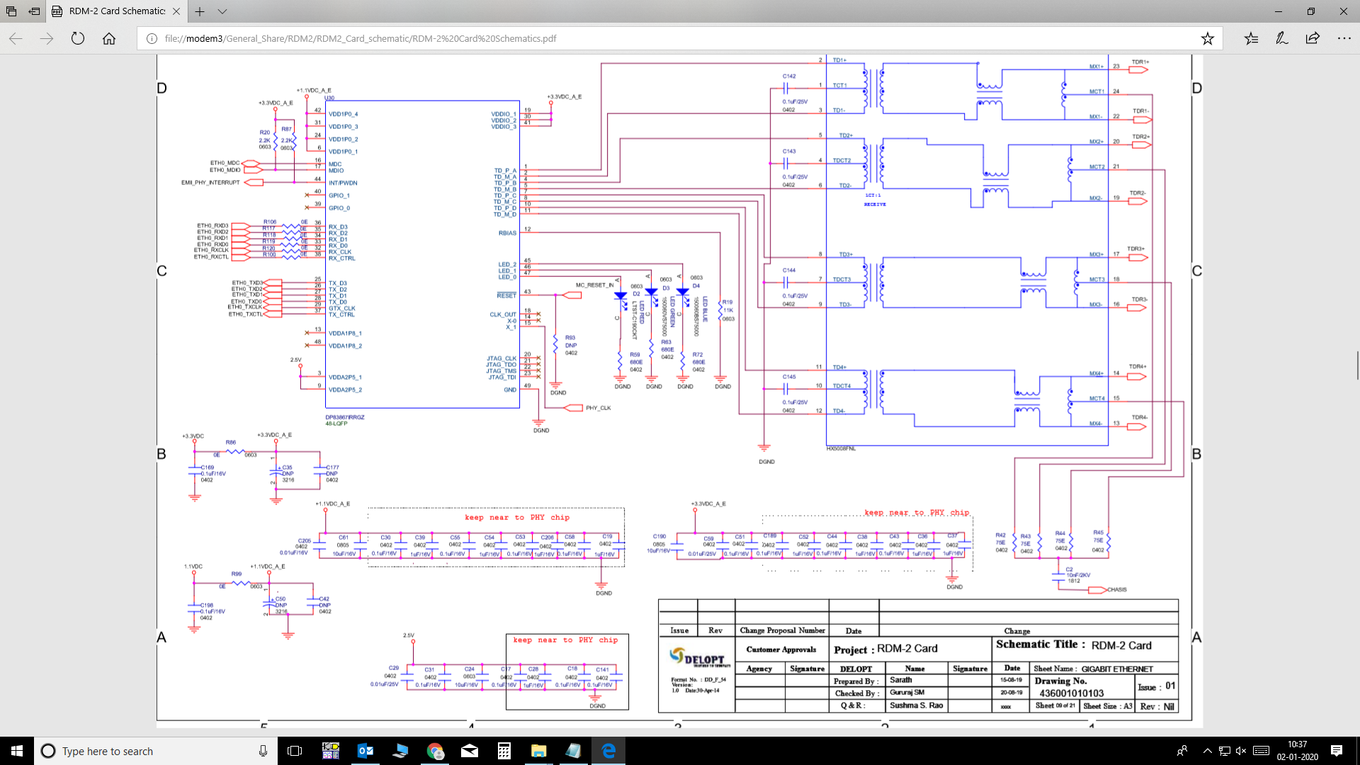

We are using gigabit phy Ethernet in RGMII mode it was working fine in my PC (LINUX RHEL 7.3 OS) but when i connect the gigabit switch between my card and PC  i cannot able ping the card and by debugging i came know that it had struck in the interrupt and it was not coming out from that until switch is Disconnected is there related to hardware or software by the way we have followed the same from DP83867 EVM schematics  please help me to come out from the issue

    We are using DP83867IRRGZ 48 pin LQFP Package for custom design below is the schematics.
    We have 25Mhz oscillator with 3.3V source and having 27pF capacitor divider (C1&C2) as suggested in datasheet, not shown in above schematics sheet.
    i am using ADSP- SC587 processor, when  i connect to switch i kept a break point over the PHY interrupt. When connected to system Ethernet port it is coming out from the interrupt and pinging, and with switch it  struck at PHY interrupt and it is not coming out until disconnect from switch Ethernet port.

  • Hello Sarath,
    Based on the difference in your register reads:
    Switch: STS1 - 0x3800 vs System: STS1 - 0x7c00
    It looks like in the switch case bit 10 indicates that "Link partner not capable of 1000Base-T Half Duplex" however register 0x0000 bit [8] indicates the PHY is set to "Half Duplex Operation".
    In the original post you say "working fine in my PC (LINUX RHEL 7.3 OS) but when i connect the gigabit switch between my card and PC  i cannot able ping the card". My understanding is with the system or PC it works fine, but with the switch, the gigabit switch in between it doesn't, please confirm this. So the first set of registers is when you can't transfer information? The second set of registers is good?
    Vibhu
  • Hello Vibhu,
    we have solved that issue by understanding  same kind of scenario in one of the forms regarding gigabit switch. So thing is when ever we connect to switch my PHY(DP83867IRRGZ ) is becoming slave and the gigabit switch is acting as master so we hard coded in such way to  that the phy will always master. That's fine is there any other method without hard coding and one of my Analog devices evaluation(ADSP-SC589EVM) board is working fine with switch and PC without  any hard coding can it  be possible to not to hard code it??

  • Hello Sarath,
    When in auto-negotiation "The Master mode priority is given to the device that supports multiport nodes, such as switches and repeaters. Single node devices such as DTE or NIC card takes lower Master mode priority." this is in "8.4.3.2 Master and Slave Resolution" section of the datasheet.
    You will have to program the part to set to master.
    Are you using register 0x0009 for this?

  • Hello Vibhu ,
     i have used same  register  and now it working fine with switch and with PC. thank you
