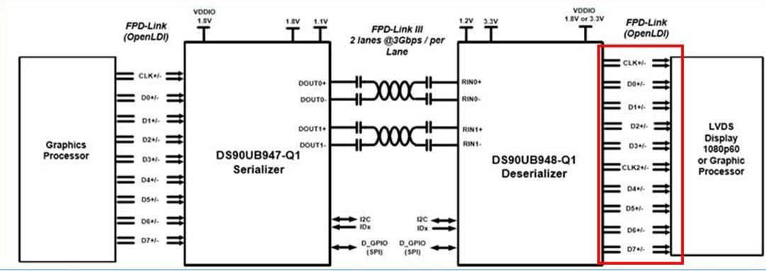

Regarding the part indicated by the red box in the figure below,
Is there a register that can turn on / off Dual LVDS output port (port1, port2) among DS90UB948-Q1 registers?

Antony,
Please use below code to disable the dual oLDI ports:
write reg. 0x34 = 0x01
write reg. 0x4A = 0x01
write reg. 0x34 = 0x02
