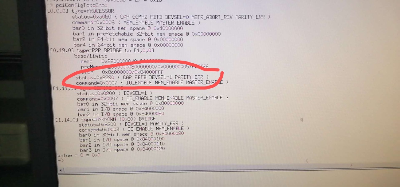

My customer found an parity issue when reading data from PCI2050, the data they get from status register is 0x8290, but right one should be 0x0290, but when they read device ID and vender ID, they are all right. Bit 31 can output 1 or 0 normally, and they already tried to replace a new chip, but result is same, so I am checking with you if some thing others will course the issue?
