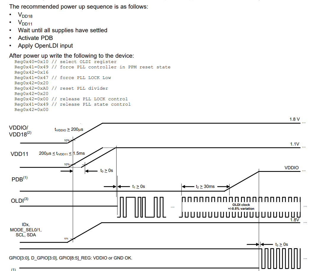

  1. In datasheet, the description of the power-up sequence is not consistent with the figure. The description said “Active PDB” first and then “Apply OpenLDI input”, but the figure below shows a reverse sequence. So which one should I active first, PDB or OLDI?

  • Hello Arie,
    1. Technically either option is acceptable as long as the programming steps for resetting the OLDI PLL are applied after the power up sequence.
