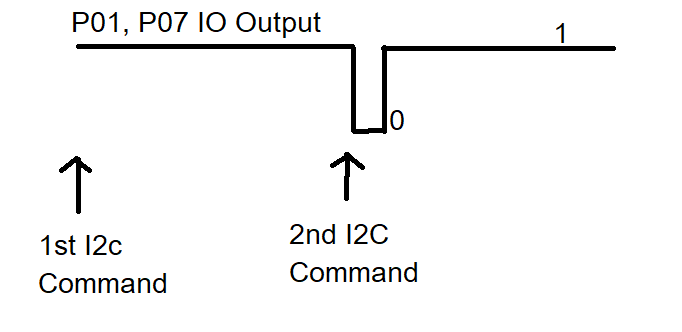

We are using TCA9535 in our design. We have configured all IO's as output and I have made PO7, PO1 as HIGH by using I2C command.
1st I2C command :
1st Byte: Address
2nd Byte: 0x02
3rd Byte: 0x41
4th Byte: 0x00
Now I want to make P02 as HIGH by Keeping previous IO states same.
2nd I2C command :
1st Byte: Address
2nd Byte: 0x02
3rd Byte: 0x61
4th Byte: 0x00
After writing the 2nd I2C command, I am seeing that P01, P07 IO's will go low and then go to High.
Is it Expected behavior? [ Refer Below diagram]
If YES, Please let me know any other part which will not be doing this behavior. We need IO Expander In WHICH io output should not be changed until I2C data changes.
if NO, Please let us know how to resolve this?

  • Hi, Harshavardhan
    Thank you for the detailed explanation and figure.
    A low pulse from the I/O Pin is not expected when overwriting a HIGH bit with another HIGH bit. The output logic for this device is flip-flop based and will only drive values that are passed in from the shift register during a write pulse.

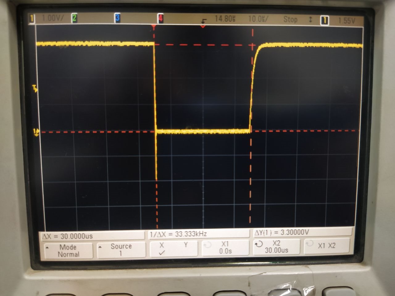

  • Hi Eric,
    Thanks for responding. Please find my comments below.
    Would you be able to share scope shots of the I2C lines during these commands?
    [Harsha] Please find attached Image
    What is the width of the pulse on the output pins?
    [Harsha] Width of the pulse is close to 30uSec
    Are there any other transactions (other reads or writes) that cause the outputs to pulse in this way?
    [Harsha] No other transactions are done while doing this.
    Is there any other transactions occurring to th IO expander before these bits are re-written?
    [Harsha] No transactions. I have verified in scope.
    What kind of load is being driven by the output pin?
    [Harsha] It is not driving any load. It connected to Test pin which is connected to scope.
    Harshavardhan.
