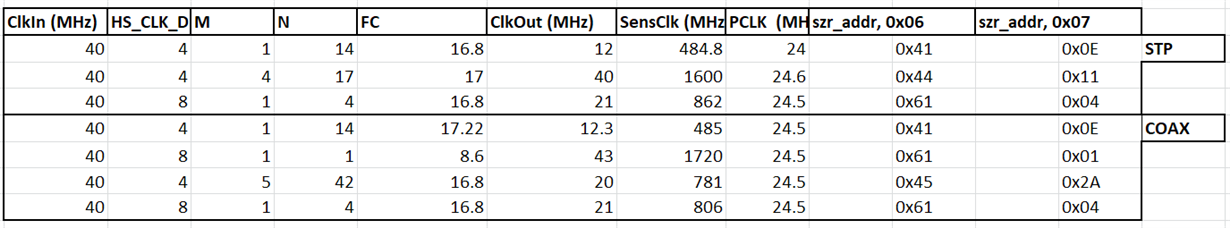

  • Here are the results of my measurements on various clocking schemes. The FC value is calculated based on the aforementioned equation, all others were either inputted or measured.
    So to clarify, the two questions at hand are:
    1) Why is the forward channel data rate so consistently misbehaving?
    2) Is it possible to operate the 935/934 link in DVP (backwards compatible) mode over STP cable?
