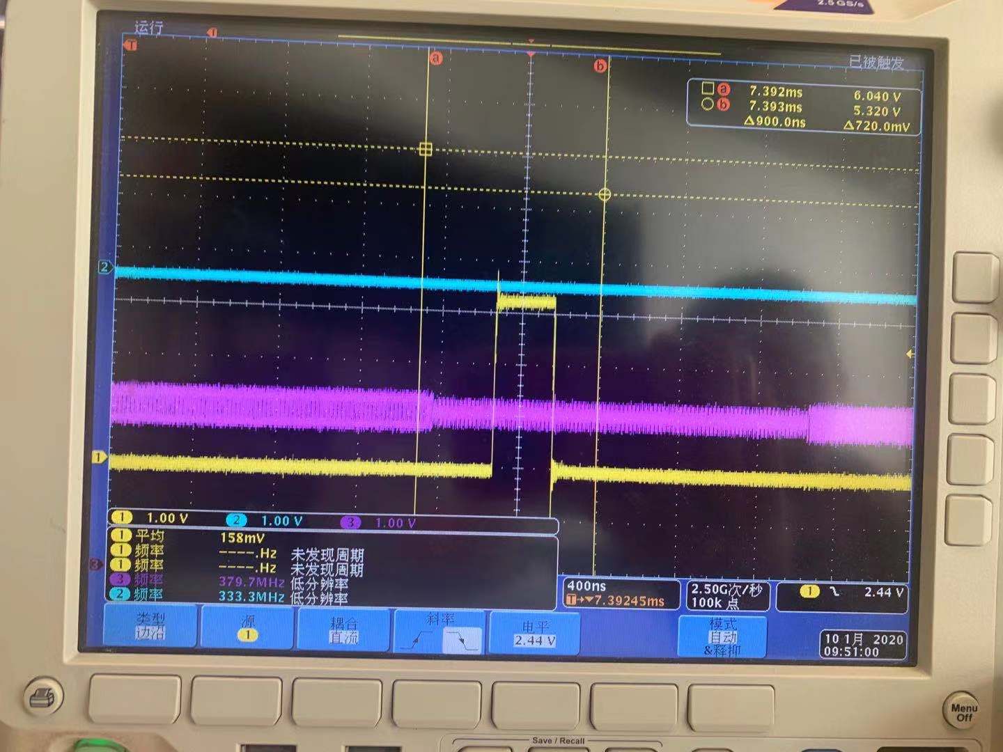

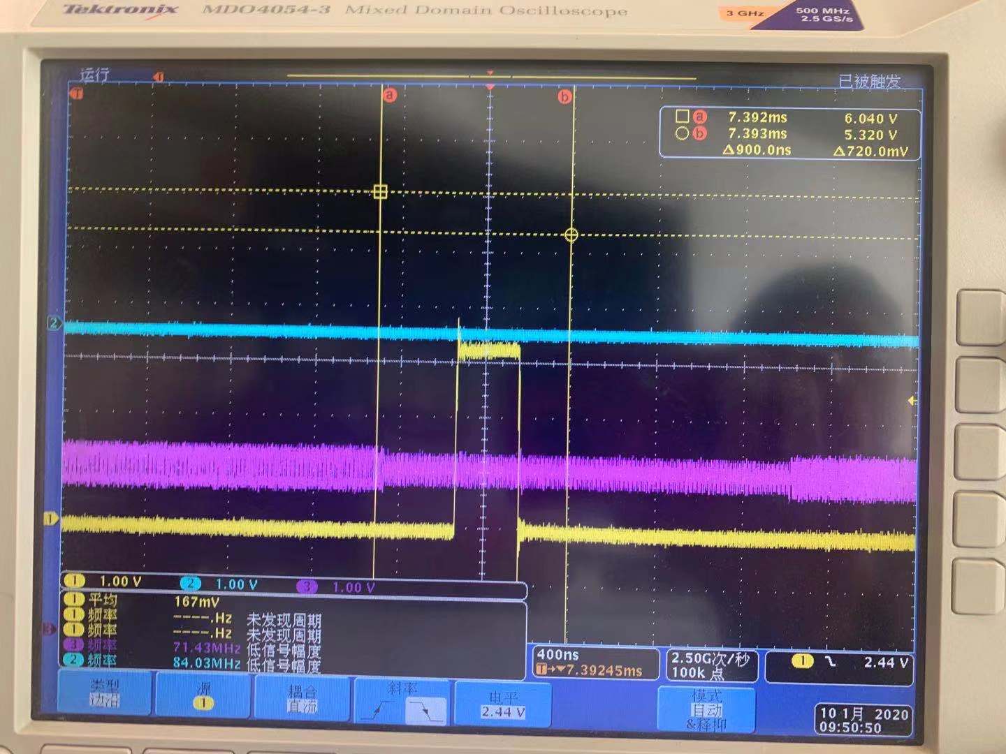

I encountered some problems when using the TFP410. When using some chips, there will be a signal loss on some displays within 3 minutes after power-on. The screen will be black, then the signal is normal, and the signal will be normal in the future.
I measured some signals and found that the output data(TX2+) and line synchronization (HSYNC)would shift(About 40ns) at the moment of signal loss.
The following are oscilloscope pictures. The yellow one is HSYNC and the purple one is TX2 +.
I suspect that this displacement caused the display to lose the signal. Which conditions will cause this signal displacement, how to avoid this signal displacement?

  • Hi I.K
    I didn't look at TMDS lanes. I saw that there was a shift in the set of data signals on the oscilloscope, just like the oscilloscope picture I sent before. This moment corresponds to the moment when the image is black.
    The HSYNC signal I give to the TFP410 has no transitions.
    In general. I saw above the data output by TFP410 that a signal has shifted. This moment of signal shift corresponds to the moment when the display is blank. I am not sure whether the output synchronization code has moved. I just think the signal movement is a skeptic point.
    Yin hao
