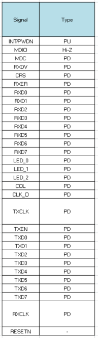

My customer has question.
In reset state, are the DP83867IR pins Hi-Z?
Or is each pin pulled up or down internally?
Regard
T kishi

Please find attached the pin states and pull-resistance values during reset.
| Signal | Type | Internal PU/PD (Ω) |
| INT/PWDN | PU | 9k |
| MDIO | Hi-Z | Hi-Z |
| MDC | PD | 9k |
| RXDV | PD | 9k |
| CRS | PD | 9k |
| RXER | PD | 9k |
| RXD0 | PD | 9k |
| RXD1 | PD | 9k |
| RXD2 | PD | 9k |
| RXD3 | PD | 9k |
| RXD4 | PD | 9k |
| RXD5 | PD | 9k |
| RXD6 | PD | 9k |
| RXD7 | PD | 9k |
| LED_0 | PD | 9k |
| LED_1 | PD | 9k |
| LED_2 | PD | 9k |
| COL | PD | 9k |
| CLK_O | PD | 9k |
| TXEN | PD | 9k |
| TXD0 | PD | 9k |
| TXD1 | PD | 9k |
| TXD2 | PD | 9k |
| TXD3 | PD | 9k |
| TXD4 | PD | 9k |
| TXD5 | PD | 9k |
| TXD6 | PD | 9k |
| TXD7 | PD | 9k |
| RESETN | - |
