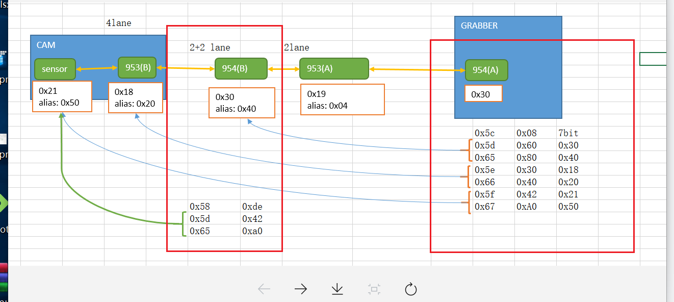

I have a requeirement of using hub to connect the DS954 with the sensor, how to configure the registers?
The handware connection is : ds954a->hub(ds953a->ds954b)->sensor(ds913a->ov10635 or ds953b->cmos).
I tried, and only get the first three devices 954a+953a+954b, the most is 954a+953a+954b+953b. For sensor ov10635, I even can't get ds913. For the other sensor, I can get ds953b, but can't get access to the cmos.
Then what registers should be configured and how for 954a+953a+954b+913a or 954a+953a+954b+953b?

    Can you please post a block diagram for the system you are trying to build? It is hard to understand from the explanation.
    Casey
  • Hi, as the picture shows.

    If I connect the sensor directly with grabber with the configration of ds954a, I can get access to the 953b and sensor.
    Then if I want to get access to the sensor with the picture show, what should I do?

    Thanks for replying. Anyway, it still doesn't work.
    My configuration is:

    I also tried to change the value of 0x58 to 0x5e, still didn't work.
    Could you please tell me why I should set the  slave id of 0x5e && 0x5f to alias addr, but not real addr?
    And where is wrong for my configuration that makes the system not work?
  • Hi xn,
    For 954A, you need to set the aliases for the sensor and 953B for the real address because these devices are not physically connected as a 954A slave (they are slaves for the 954B). We want the 954A to simply propagate the I2C address to the 954B, and have the 954B to remap the alias to the real address.
    Definitely set 0x58 = 0x5E. Which device(s) are you not able to communicate to? Can you make sure the address you are communicating to is correct in terms of 7-bit or 8-bit?
    The diagram you provided has the addresses in 7-bit right? How come 954A says I2C address 0x30 and you are talking to 0x3D in the code?
    Also try setting 953a alias to an address other than 0x30.
    Jiashow
