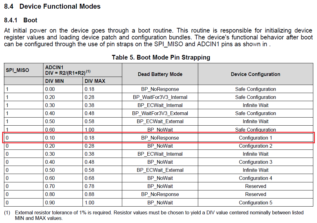

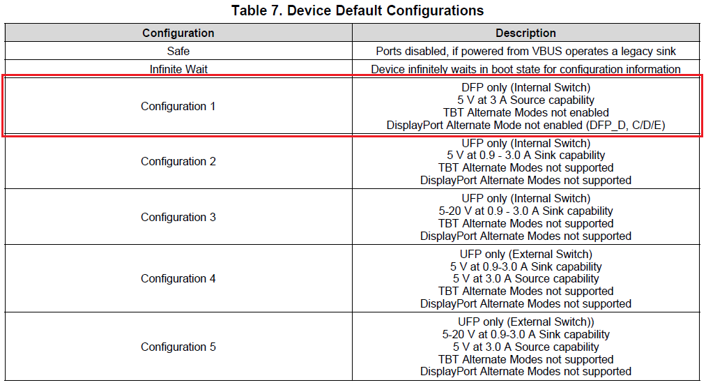

Hi Experts,
Our customer is using TPS65987D to achieve a basic 5V VBUS output type-c DFP application by using internal configuration 1. But they want to achieve 2A maximum current limit function. Can we to support this function? How to set the device to support it?
