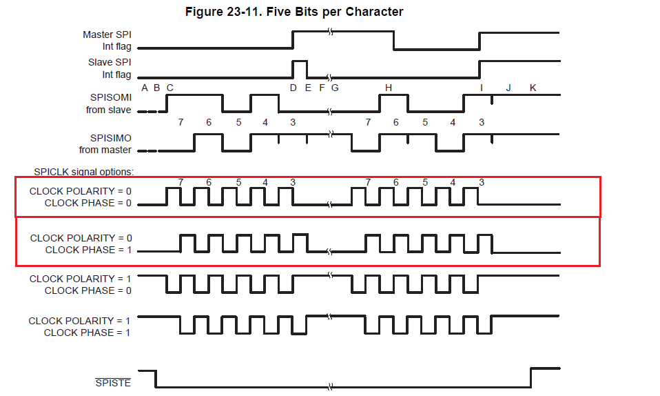

And, I have made TCAN4550 SPI Drv. But I think It’s not working now.
I referred datasheet came from TI like below while developing a SPI Drv.

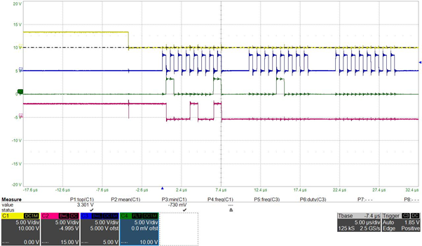

As a result, I’ve made result like below. (Read mode register(0x800) frequently.)
Yellow: nCS, Blue: SCK, Green: SDO (based on MCU), Red: SDI (based on MCU)
At the first time, I thought, It worked very well.
But all of sudden I realized that there were some troubles like below.
First problem is that sometime I can’t read correct data came from TCAN4550 through SDI.
Second problem is that some minute later MCU can’t any data unless TCAN4550 IC gets H/W reset. I mean, I just can read 0xFFFFFFFF like below picture before
