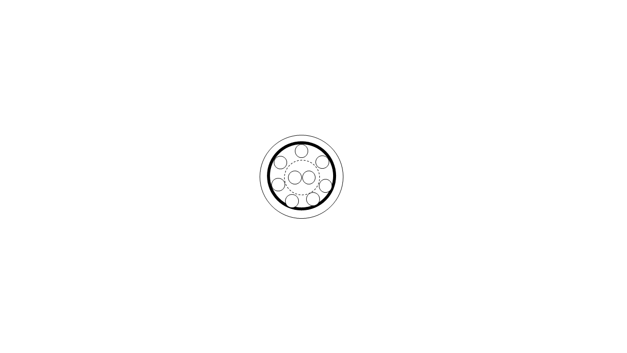

  • Bobby-san,
    I have got more information from the customer as below.
    Length : 40m(max)
    Frequency : 50KHz
    cable : composite wire (like below image)
    Thanks for your kindness.
