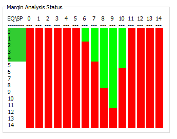

  • Dear Jiashow,
    Here you can find our Margin Analysis of our system:
    In my opinion and because we are using 2m cable (Around 20cm of Leoni Dacar 462, about 1.5M of Leoni Dacar 462 and 20cm of Leoni Dacar 302), It seems our Margin Analysis is a bit poor, because you have metrics with 15m cable, which have better Margin Analysis, we will need to review or completely system, Do you agree?
  • Hi Carlos,
    The margin doesn't look too bad, especially considering there are two interconnects in the system. Having interconnects can make the margin smaller. If your system is only going to be using 2m cable then this margin should be fine. You can also consider upgrading to DACAR302 cables. They tend to be less lossy.
    Jiashow
  • Hi Jiashow
    Thanks, I will try with Leoni 302, but I think this wont solve our problem in Immunity, we have been checking the S11 parameter in the Serializer side, and we are near 5dB in the range between 1-2GHz, so we are out from your recommended specs (954 Datasheet) correct me if I am wrong.
    This could be part of the problem. Anyway I would like to ask you, if you suffered problems before related to this test, and If there is any recommendation, for example to change the parameter of the EQ and SFILTER, of course fix the limit values of que EQ and Strobe to the parameter we obtained in the Margin Analysis....
    Thanks and regards!
  • Hi Carlos,
    From the software perspective, you should definitely set the min/max for the EQ and strobe position. You can manually set the min/max for these parameters via registers 0xD5 and 0x41. Check the app note for more information: http://www.ti.com/lit/an/snla301/snla301.pdf
    Jiashow
