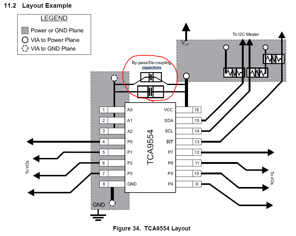

Let me ask what are the by-pass capacitors recommendation for TCA9554.
I found that there are 2 by-pass capacitors connection recommended on the datasheet but can't find the best value combination.
Could you tell that?
Thanks in advance,
S.Sawamoto
  • Sawamoto-san,
    Typically a 0.1-uF capacitor is sufficient for this device.  Sometimes multiple capacitors of different values or package sizes are combined in parallel in order to provide a low impedance across a broader range of frequencies, although this would depend on the expected noise on the power rail and capacitor-specific parameters like the expected self-resonant frequency.
