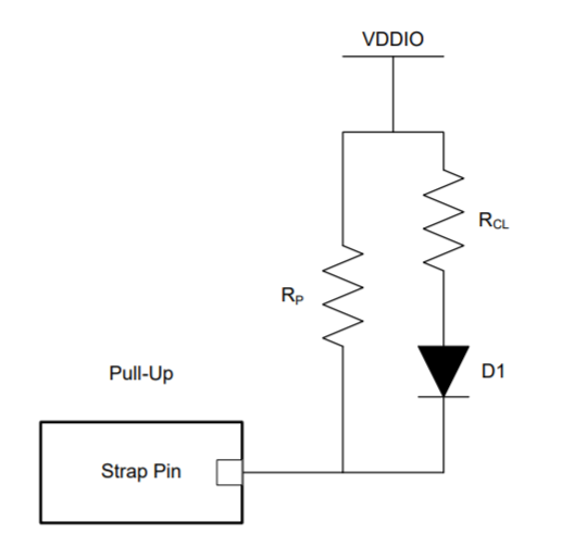

I would like to ask a question about LED_1 pin in DP83822I.
Our customers are considering replacing TLK110 with DP83822I.
At that time, the data speed (100M or 10M) that has been confirmed by the LED connected to the LED_SPEED pin of the TLK110 is to be confirmed by the LED connected to the LED_1 pin of the DP83822I.
If you check the data sheet, I think that you can check the data speed in the same way as the LED_SPEED of TLK110 by connecting as shown in the figure below.
(In TLK110, the LED and the resistor were connected by pull-up, but in DP83822I, there is a notation to connect each by pull-down, so our customers are worried that they can be used in the same way.)
If you need other settings, please let me know.
