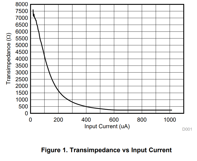

I am trying to understand how figures 1 and 5 in the ONET2804TLP datasheet relate to each other. I would expect that the transimpedance of the amplifier would be defined as the gradient of the I-V curve in figure 5. However figure 1 shows that it is still non-zero for input currents where figure 5 is flat. How, then, is the transimpedance defined in the case of figure 1? And what is the reason that the transimpedance is not flat for input currents up to ~50uA (then dropping rapidly to zero)?

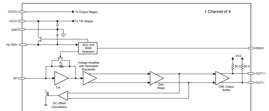

    This is because there are different stages of the device that determine the differential output voltage. The transimpedance that the datasheet is referring to in figure 1 is the feedback resistance across the TIA stage shown in the block diagram below: The differential output voltage in figure 5 is the final output after the signal has gone through the gain stage and output buffer. Hope this clarifies things!
