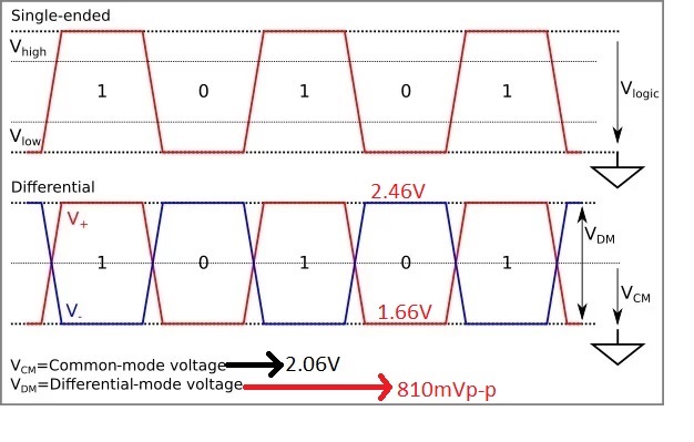

Hello, I am using the LMH1297 for an SDI Video application. I have the IN+- and OUT+- Differential pairs going to an FPGA transceiver pins. I've looked through the LMH1297 datasheet to determine is those diff pairs are CML or PECL or something else. The Xilinx Ultrascale+ FPGA supports LVDS, DIFF_HSTL and many others. I have tied the VIN pin to 2.5V.
Can anyone tell me what is the I/O Standard on the IN/OUT Diff pairs?
Thank you,
