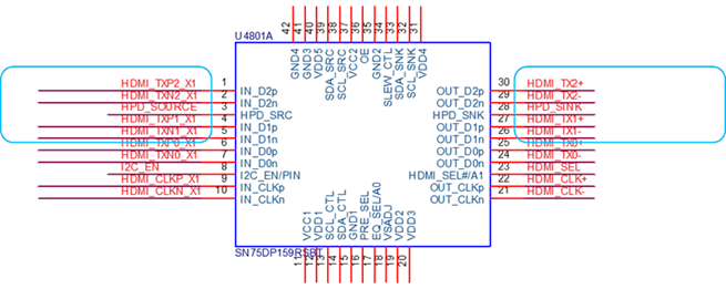

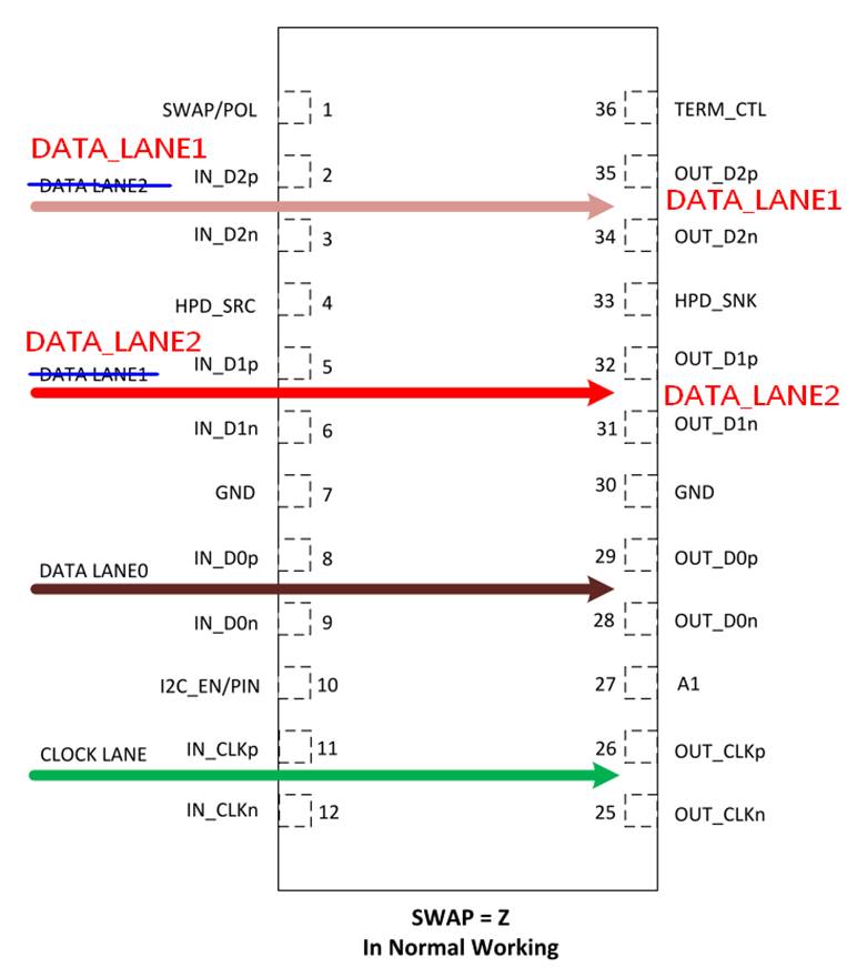

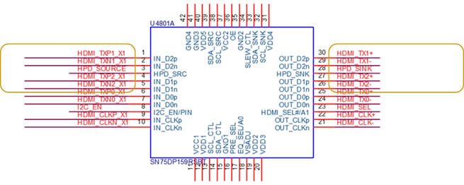

Hello expert,
My customer would like to know if we can lane swap input signal like below picture. Change TX1 and TX2 from input. TX2 input should connect to pin1 and pin2. TX2 output should connect to pin30 and pin29 originally.
Now they would like to change that TX2 input should connect to pin4 and pin5. TX2 output should connect to pin27 and pin26. Does the HDMI signal still work normally?
Original
Now
