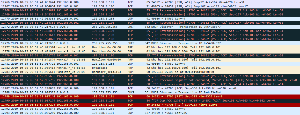

In my design I suffer random Link-Downs which last about 12-15s.
These happen about once a week, sometimes more often.
The last message before the linkdown is at 06:51:41.034034, the first one after the linkup is at 06:51:52.985755 (~12s no link).
The reset of the socket is the consequence of the linkdown.
=> Did anybody suffer from simmilar problems?

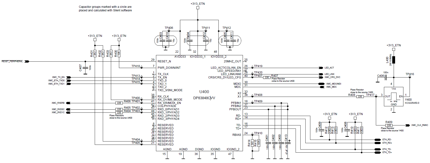

Today I will play with the values of Rbias. (Currently the have 1% tolerance each). According to some topics in this forum there might have been similar problems.
  • Hello Mathias,
    It does look like your RBIAS is slightly off from the recommended resistor value, are you able to test this with the 4.87 k-ohm resistor?
    Vibhu
  • Hi Vibhu
    I'm still waiting for the ordered 4.87kOhm 0.1% Resistors, but I did measure the current values:
    Vbias=1.1857V
    Rbias=4.85kOhm (which would be within the 1% range, but when you do the math it could be slightly out of range with 1% resistors, I agree)
    So you say a "not perfect" Rbias could lead to random Linkdowns?
    In this case one of my next steps would be the opposite way: go to 4.7kOhms for example and check if the same behaviour happens more often...

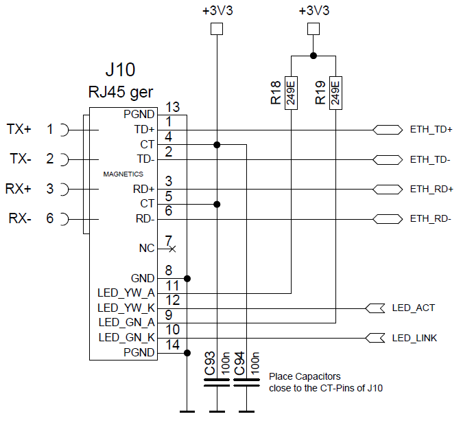

    Here the rest of the schematics:
    Other information:
    - The link partner of the DP83848CVV is a switch. We tested different switches and always had the same error.
    - Just the link between the DP83848CVV and the switch's port to which it's connected with breaks down
