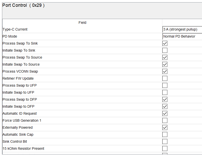

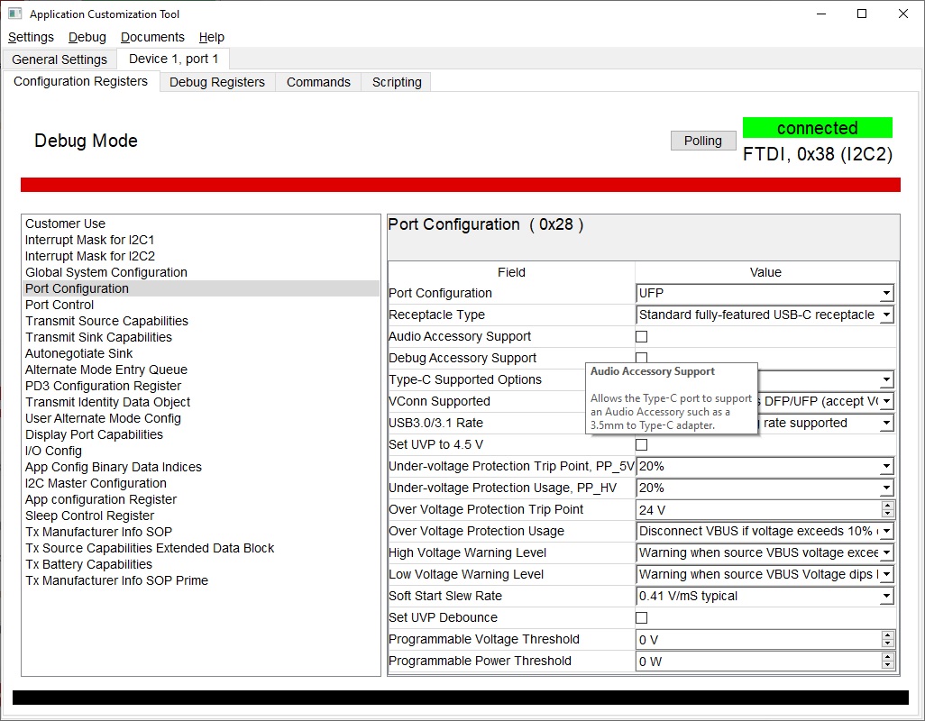

I try to use the GUI tools and the TPS65987EVM for a new prodruct developpement
on the USB-C I always connect a Galaxy S40 smartphone ;

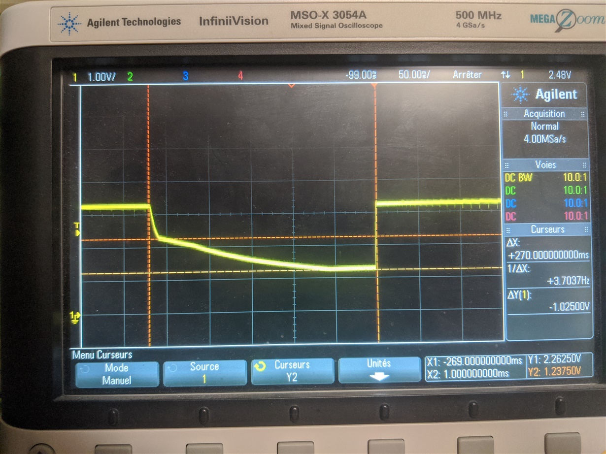

The TPS65987EVM SYS_PWR is connected to a power supply 5V 2A
The goal is when the power supplys is on the Galaxy S40 must be charged (sink mode) , when the power supply swithc off  the S40 must swap to source to power up the board.
Could you welp me to set up the  TPS65987, because since now I was not able to manage this.
Also do you have any documentation about the regiser and command of the TPS65987.
