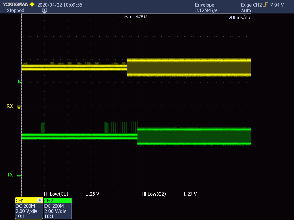

    I think I got to root of the problem. And it's very likely that it isn't the DP83848I.
    I had a closer look at the Fast Link Pulses (FLP) during Auto-Negotiation:
    • The test PC that I used for all my tests was particulary "good" reproducing the link problem.
    • As it turns out, the FLPs that the DP83848I receives from the test PC on it's RX-pair are significantly smaller than compared to those the TX-Pairs (see the picture)
    • I double checked this by measuring the test PC signals without any link partner physically connected to it.
    • Then I used a longer 10 m Ethernet cable for the connection betwenn my DUT and the test PC. As expected this attenuated the FLPs by another few milivolts.
    • What was utterly unexpected: the link problem was gone!
    My guess what happend:
    • The low amplitude FLPs were above the threshold of the DP83848I to detect them (at least partially). Though it did not switch to MDIX
    • The low amplitude may have caused receive errors that prevented to establish a proper link
    • With the longer cable the FLPs are below the threshold of the DP83848I. Though it only sees FLPs on the TX-pairs, switches to MDIX and everything works fine.
    I'm going to look for other PCs or Ethernet switches where the link problem was observed. I will get back an report if I found out anything new.
