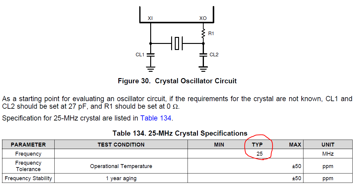

Let me confirm about acceptable crystal frequency range for DP83867E.
The datasheet doesn't describe the min/max range but is the 25MHz crystal mandatory to choose?
(As a background of this question, I'd like to avoid an interference to GNSS frequency if possible.)
Thanks in advance.
